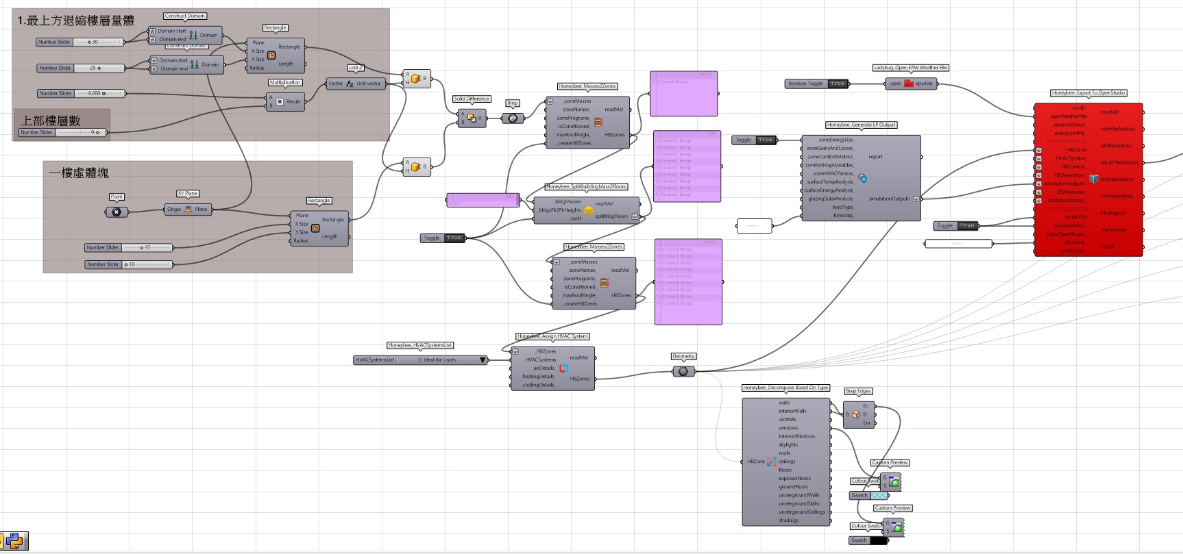

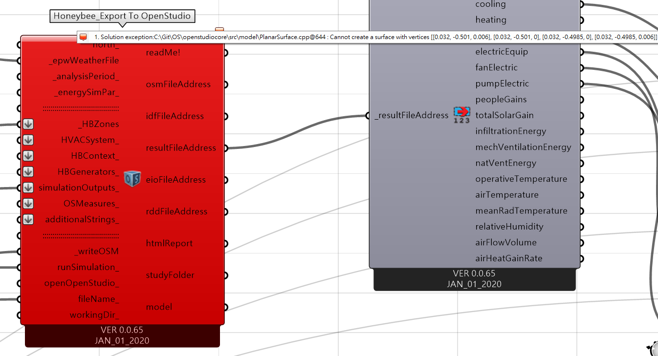

Want to ask why there is an error in openstudio like this? Can someone tell me where the problem is? Thanks!
- Solution exception:C:\Git\OS\openstudiocore\src\model\PlanarSurface.cpp@644 : Cannot create a surface with vertices [[0.032, -0.501, 0.006], [0.032, -0.501, 0], [0.032, -0.4985, 0], [0.032, -0.4985, 0.006]]
why0820.gh (151.3 KB)

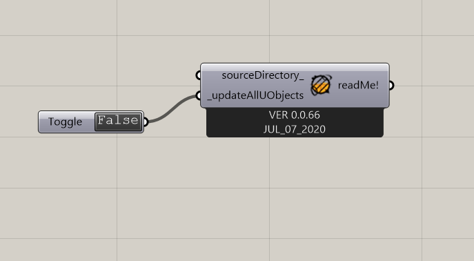

@Tai , I couldn’t recreate the error here. The simulation is running fine for me.
Update your legacy version and try again.

Unfortunately, I still get errors after updating the version. Can I ask a question about your openstudio version?Thank you!
Mine is openstudio2.5.

I get it !!! Use openstudio2.9 it will be work。
Thank you so much!
