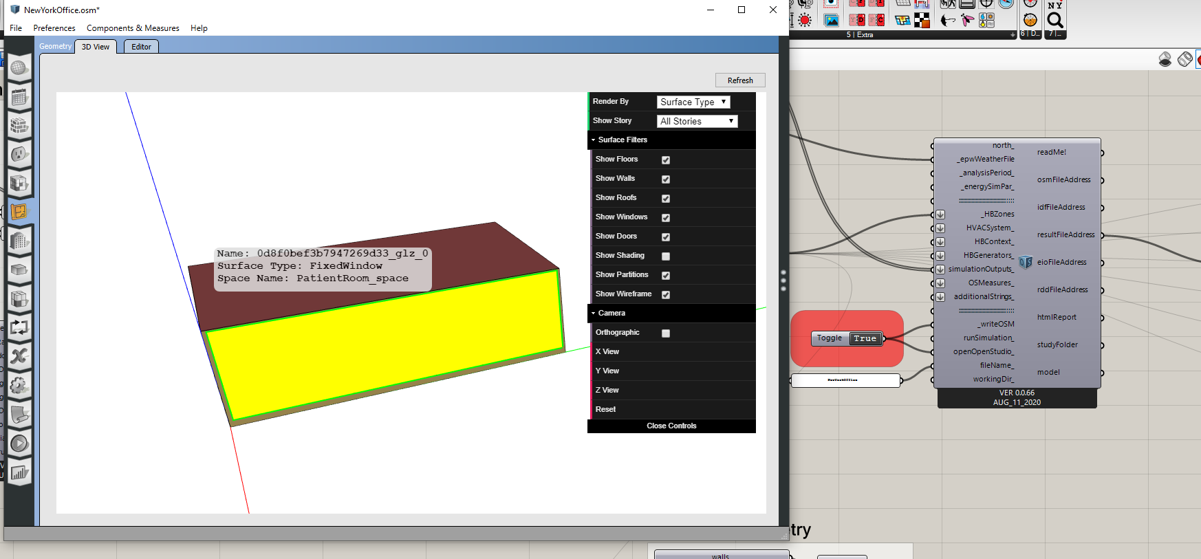

@zdenom ,
I am unable to recreate the issue on my end and all Honeybee-Legacy sub-faces are being translated to FixedWindows in OpenStudio:
Are you using the latest version of the legacy plugin on Food4Rhino? And what version of OpenStudio are you using? Is it 2.9? If upgrading Ladybug Tools and OpenStudio does not fix it, please upload a sample file that helps us recreate the issue.
