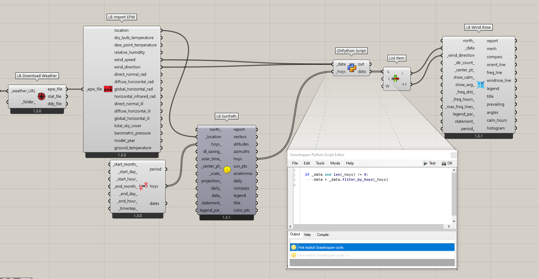

I attached my not elegant way of taking the night hours.
Picture: The definition is from the example files. When i compare your definition with my definiton its kinda different (i tried to use the average Sundawn and Sunrise). I mean its clear that your definition must be more exactly because of the use of the Azimut. I am also wondering i can let the_statement by default?

The hoys that come out of the sunpath are only for the sun-up hours. So, yes, they all have a solar altitude that is greater than 0. All that the Python component is doing is filtering the wind speed data by these hoys. You can plug the output of the Python component into an HourlyPlot component to see the values that are actually being passes to the wind rose.
Yes, the other non-python ways that I was referring to involve a statement_.

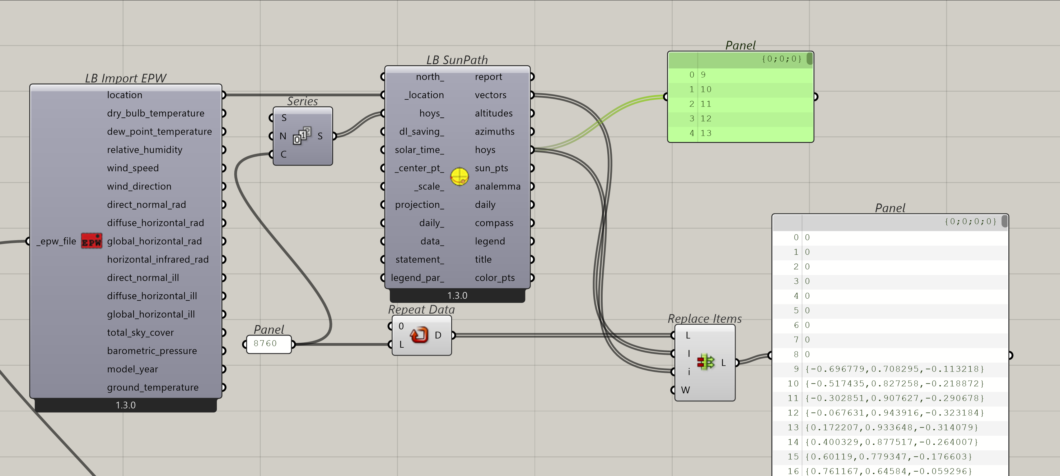

Take the hoys output from the sunpath component and process them with some native Grasshopper components to get a list of the integers between 0 and 8759 that are not in the hoys output by the Sunpath component. The “Series” component and the “Cull Indices” component will probably be your friends here.
Had a similar isue last week and did it like this:
I was surprised when the sunpath component expected values between 0 and 8760. Seems to be one hour too much.
