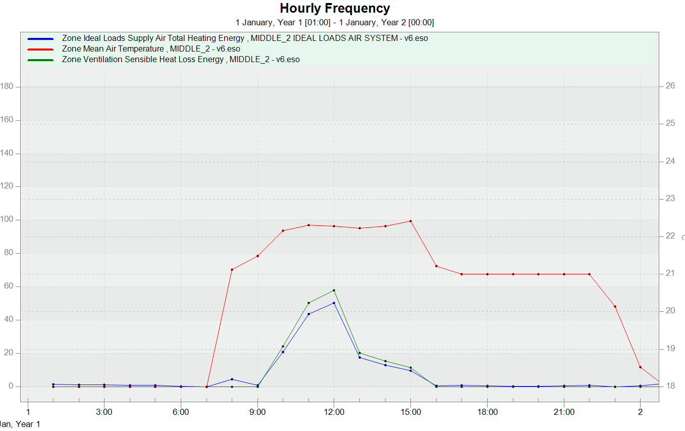

this is january first’s results, reaching 22 degree with 100 kwh consumption

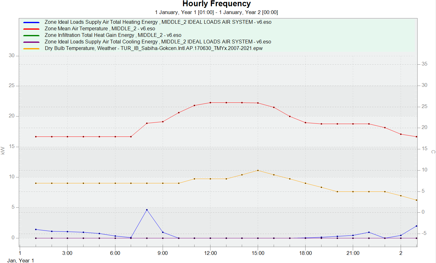

and this is without natural ventilation, still reaching 26 degree without cooling
