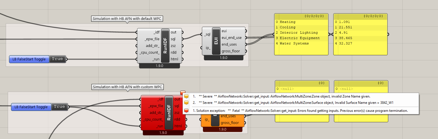

Your example file works, even when I replaced it with another simple geometry. However, an error occurred in the HB AFN with custom WPC integration when I replaced it with my apartment model.

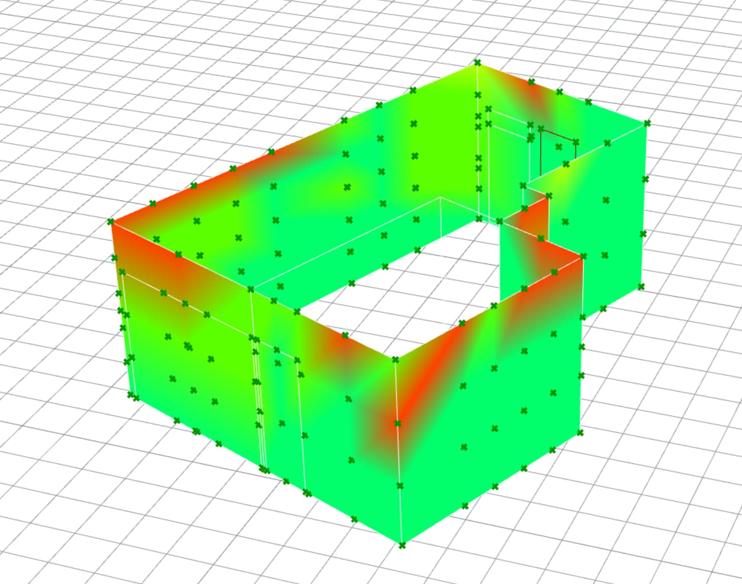

I believe the pressures were calculated (as indicated by the shaded image), but the error appears to arise from surface/zone name translation not being recognised. I even tried editing the names directly in the IDF, but it ended up the same.
Do you have any ideas on how to resolve this issue?
Thank you for your time again!
-Hirda
Please check if the surface names generated by first cluster component exist in HB model. Also share ur workflow if possible.
