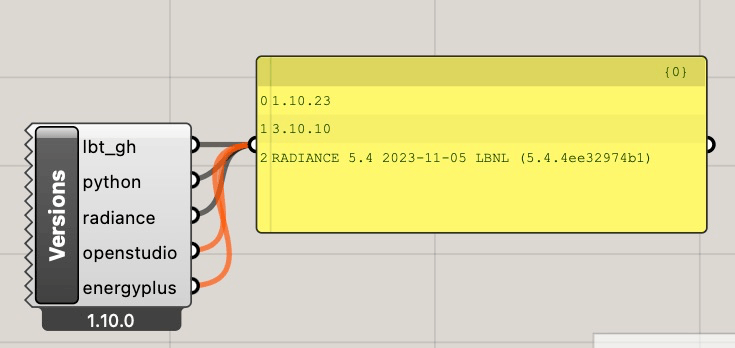

@chris I seem to still have this issue. I have downloaded the latest installer on Food4Rhino 2026-05-04, and even after using the LB versioner to the latest version, still have issues with these Radiance post components.
