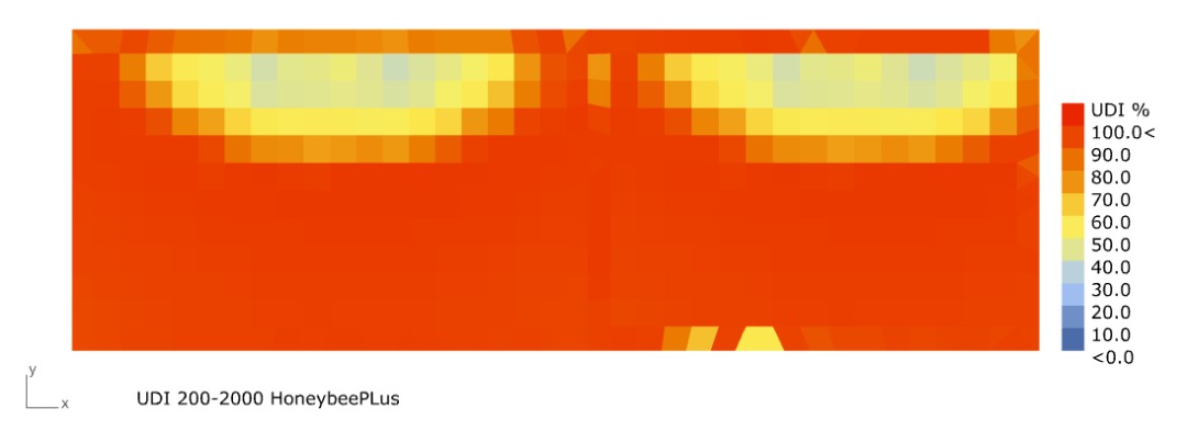

second, To select the versions for the daylight analysis, I doubt whether to work with Honeybee plus or the new Honeybee (Radiance Tab), so I tested them. What happened was very strange, the results of the two analyzes were very various. on the other hand, it seems that the results of the new version are not logical at all !! Please guide me.

The default Radiance parameters in LBT plugin is more relaxed. Try to use the same Radiance parameters and the results between [+] and LBT plugins should match closely.

There’s a component for radiance parameters in both the legacy and [+] libraries. You can reuse the [+] component for honeybee-radiance too.
I tested in LBT and set the radius parameters and the results were better, but the results in [+] seem to be much better than LBT and I do not know exactly what values and settings are set for it by default.

hi @Mohammad.hakim.a. I edited a little bit of your definition and ran the test. Now it’s calibrating very well between two versions. I added similar occupancy and a common radiance parameter for both. And please update to latest development module. I ran with radiance 5.3.annual_daylight_tested_Revised_Final.gh (154.8 KB)
