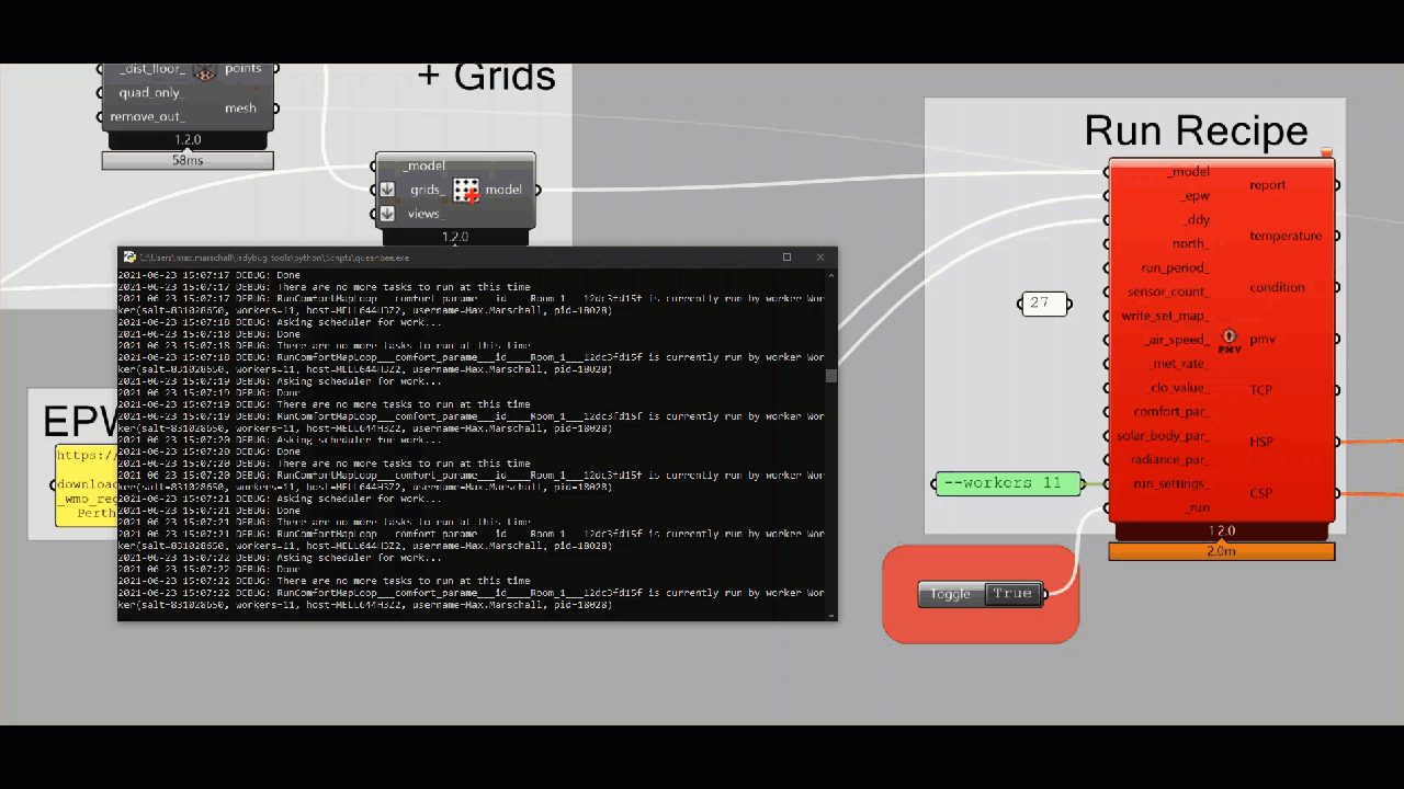

  2. When running in parallel, the simulation sometimes seems to get hung up for several minutes, with the same message in the command window repeating over and over - something about how “There are no more tasks to run at this time” (sorry for the poor screenshot resolution):

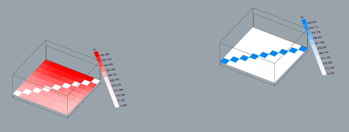

  3. I’ve been setting up this parameter study which is now running, but the diagonal of the room is getting weird results (other than the diagonal the results look fine):

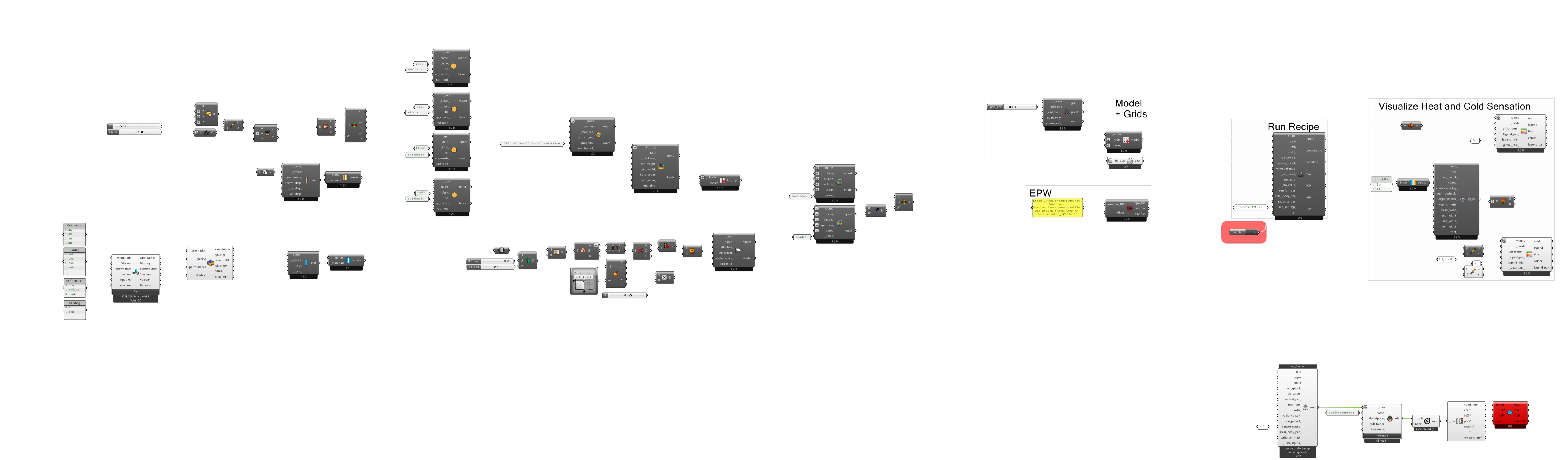

    comfort_mapping diagonal.gh (74.0 KB)

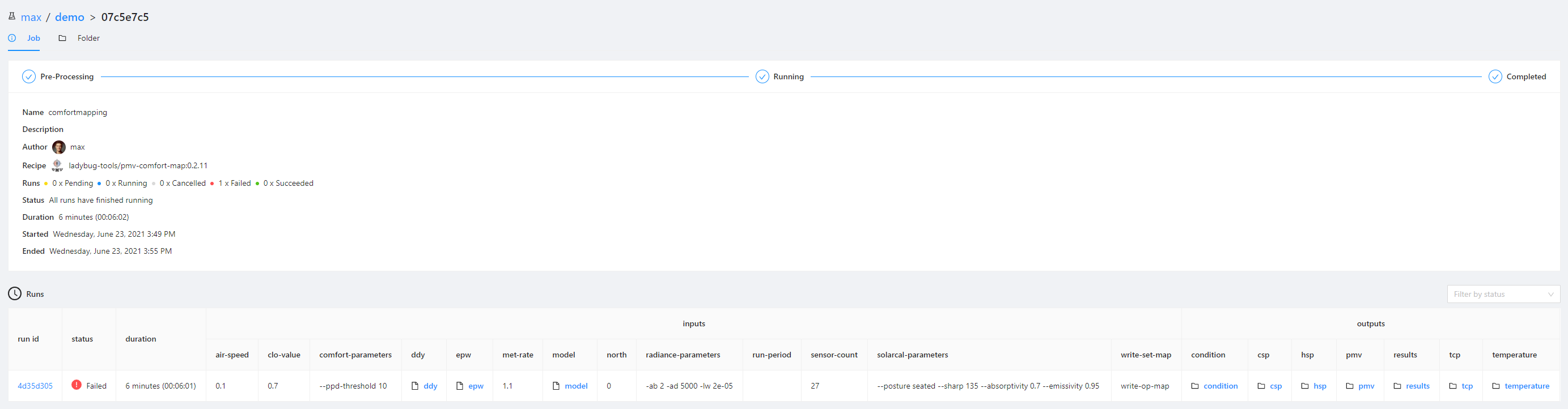

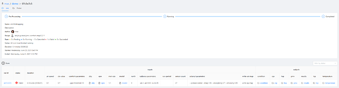

  4. As you can see from the definition above, I have also tried running it on Pollination (07c5e7c5-042a-4030-9ae7-0793ed3ab8c7) but it fails and I don’t understand why:

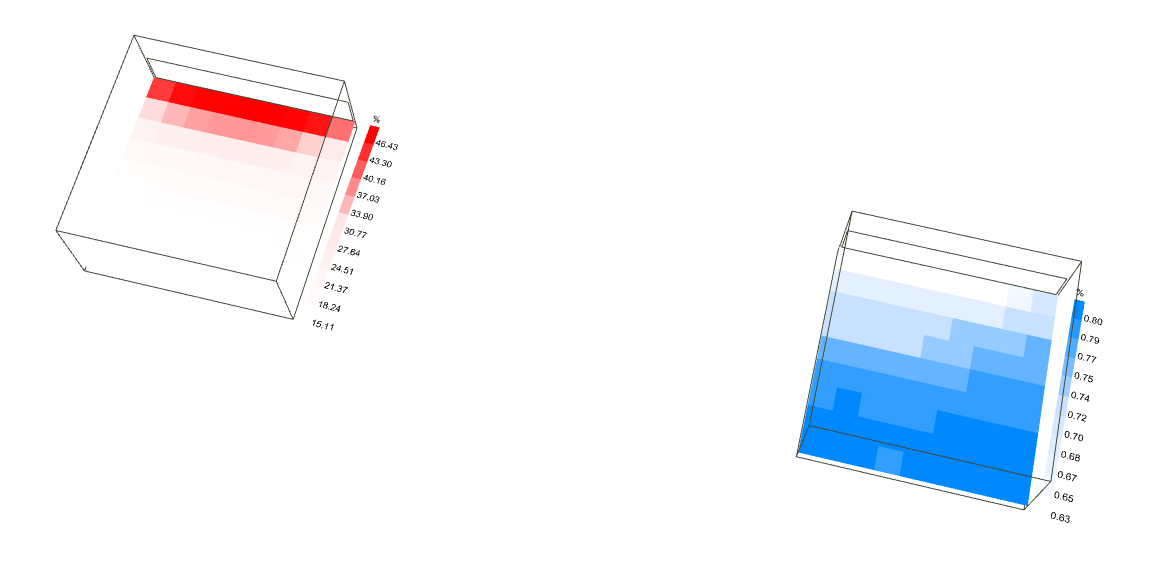

@MaxMarschall ,
Your file has a bunch of extra dependcies on other Grasshopper plugins so I wasn’t able to run it in the same way you did. I’m not able to get the diagonal on my end:
If the component turns red, then something failed in the simulation and you should either use the report_out_ option to see what the error is or you should check the text file in the __logs__ folder within the simulation directory.
I don’t see that job on Pollination but we could also check the logs there for any error messages.
