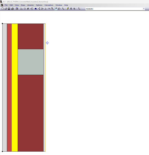

I’m confused here about how to solve this, since the boundaries are just straight lines As opposed to what @Gspahr [reported here]

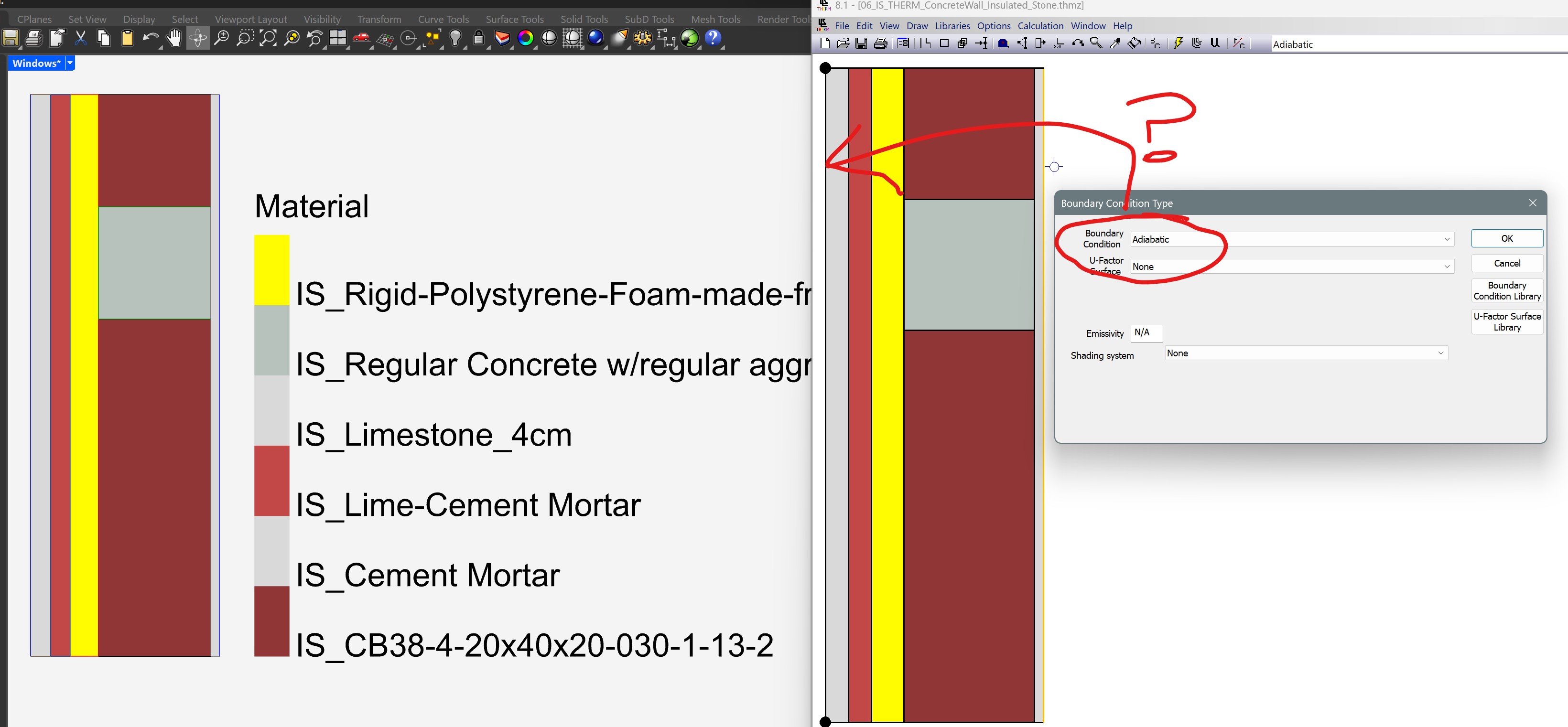

When opening in Therm instead of recognizing the Exterior boundary as such, it says it is adiabatic. Like so:
Attached FFjson, THMZ, and GH, if you have the chance to check them.
I believe there is something basic I’m not getting regarding how to define boundaries, since other wall sections also complain about this [though there are few that are fine]. :thinking:

I am missing any FFJSON among the files that you uploaded here, which I might need in order to know exactly what went wrong. But I can see in the THMZ file that you uploaded there is no exterior boundary condition:
So that is the part that is failing for you. Maybe this is a tolerance issue where the line you have for the exterior is close but not touching within the tolerance.
I’ll try to take a deeper look but the FFJSON would be helpful since that will help me understand what units and tolerance you are using on your side.

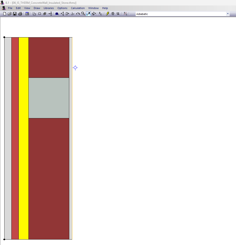

Yes. I see this in Therm. There it identifies sit as adiabatic instead of exterior, even though it was defined as such. It is just a straight line.

It was a rather dumb bug on my part. I forgot to add a check to be sure that all Shapes had counter-clockwise vertices in the exported THMZ file. So you had one Shape geometry in your .gh file here that was flipped in terms of its direction from all of the others (or you drew it in reverse if it was just a Rhino polyline). This was causing the boundary condition that was attached to it to be unrecognized by THERM.

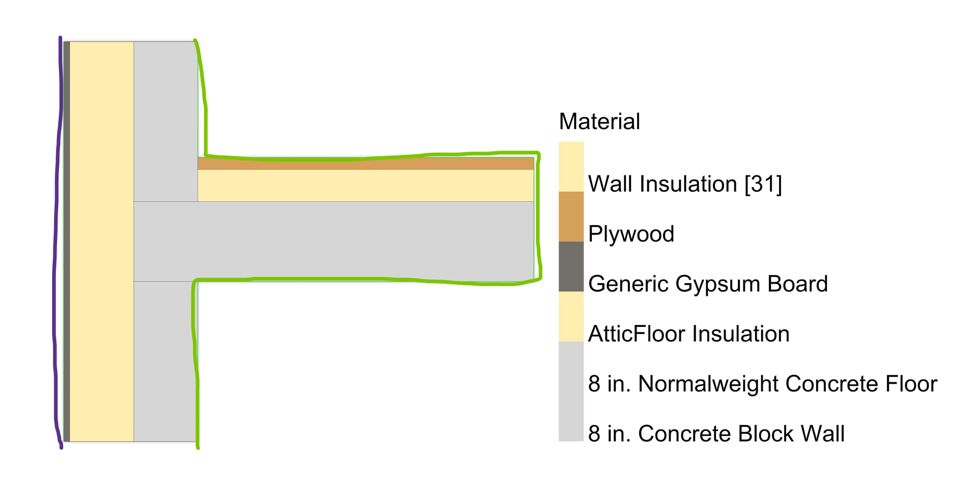

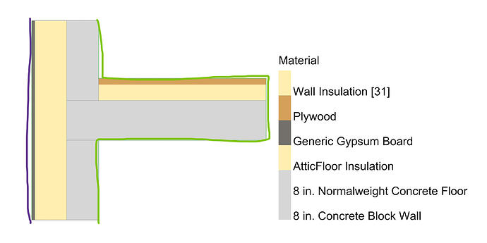

Hi, I wanted to test a component thermal bridge and I’m facing an error with my boundries. The error on ColorShapeAttribute: Solution exception:ColorShapes must have at least one shape. The purple line is showing how I’ve drown my exterior line and the green stands for the interior. Any ideas why is that wrong?
Hey @MartaG ,
From the exception message, it seems like you connected a Fairyfly model to the component that has no FF Shape assigned to it. So there is nothing for the component to color for you.
