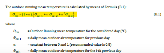

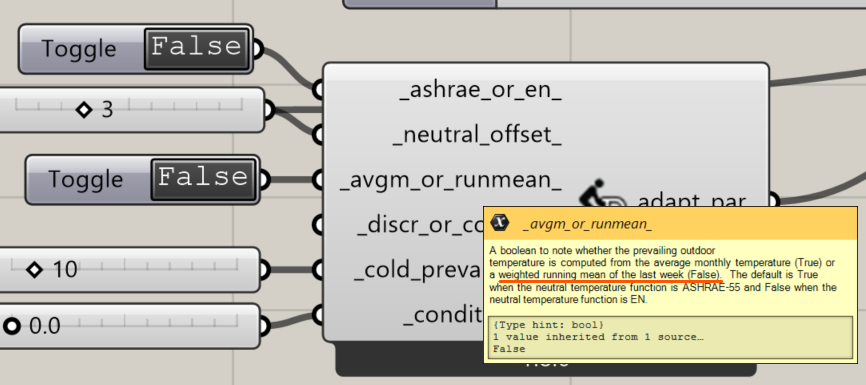

Hello everyone,
I am analysing adaptive comfort relying on the standard EN 16798-1.
As Olivier highlighted, the standard considers the outdoor running mean temperature as calculated on the mean temperature of the three days before:
Instead, it seems that LB adaptive comfort adaptive comfort parameter tool consider the seven days before:
Could you please explain how you set the calculation of the outdoor running mean temperature, please?
Thank you in advance,
best regards.
Erika
Hi @erikas ,
You are right that the ladybug code computes the running mean using the data from the previous week as was originally recommended by the researchers who developed that adaptive thermal comfort model:
But you can see in the formula how quickly the impact of the days drops off if you use a high alpha value like 0.8. Day 4 only accounts for 10% of the daily running mean and the days keep dropping off from there.
I feel like they just truncated the formula in the EN 16798 documentation to make it easier for users to calculate. I highly doubt that anyone would say that you have not followed the standard just because you made better use of your available data and computer to account for the effect of the previous week rather than the last 3 days.
But, if others feel strongly that this needs to be changed or exposed as an option, I can try to block some time off to implement it when I get the chance.
