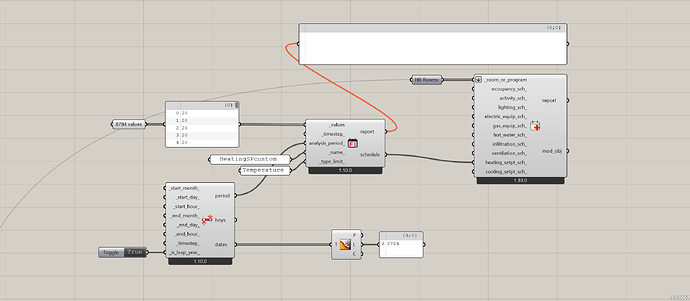

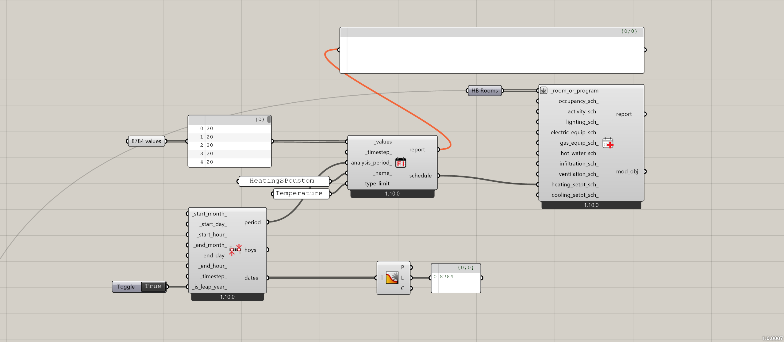

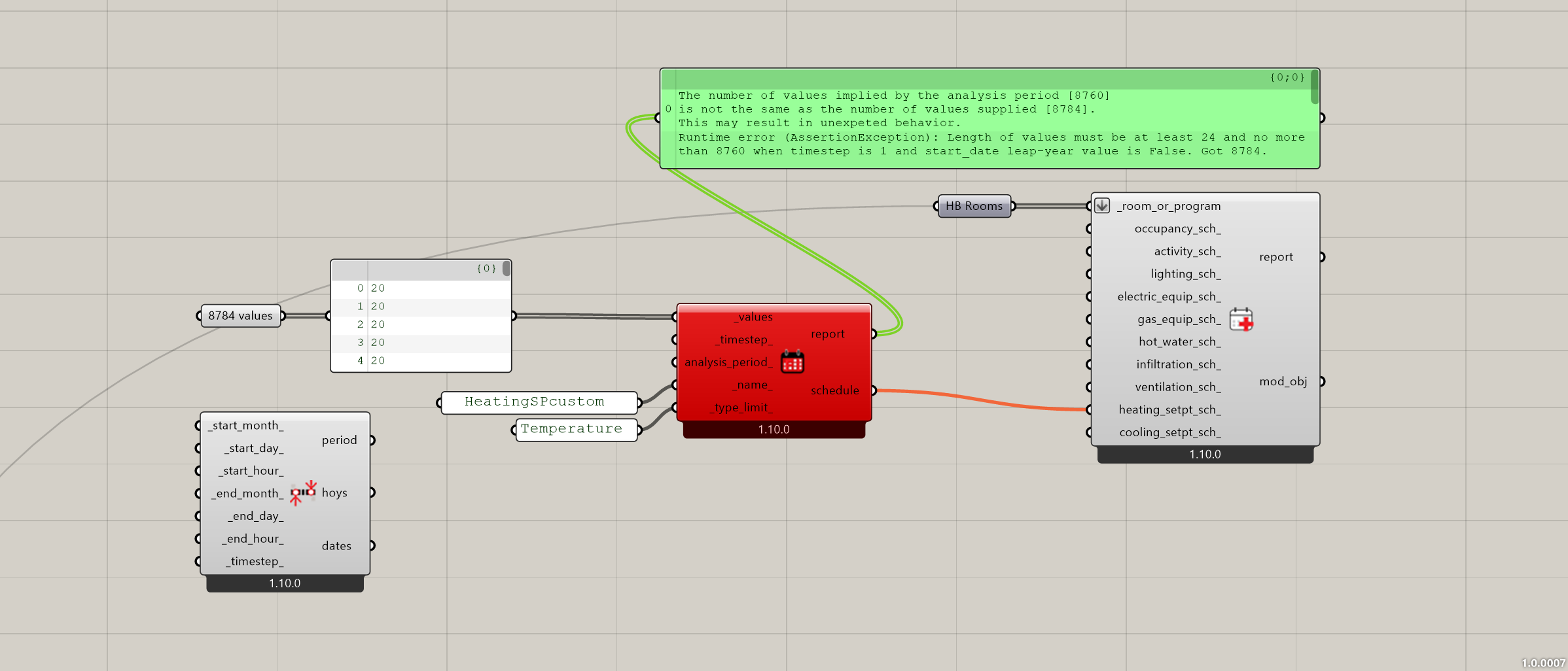

I ran into an issue using fixed schedules with leap years.
The Fixed Interval Schedule component expects 8760 values (standard year, timestep = 1), but I am running a leap year (2024), and if i supply 8784 values it gives this error:
If i supply 8760 values, the fixed schedule gets written into the idf but runs out on December 30th (since February 29th eats a day that isn’t accounted for), and E+ crashes with:

@Vuth also suggested that exposing is_leap_year in the Analysis Period component lets the fixed schedule accept 8784 values directly, and it works fine.

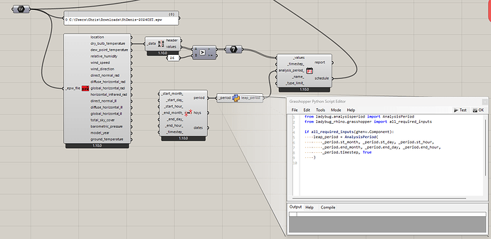

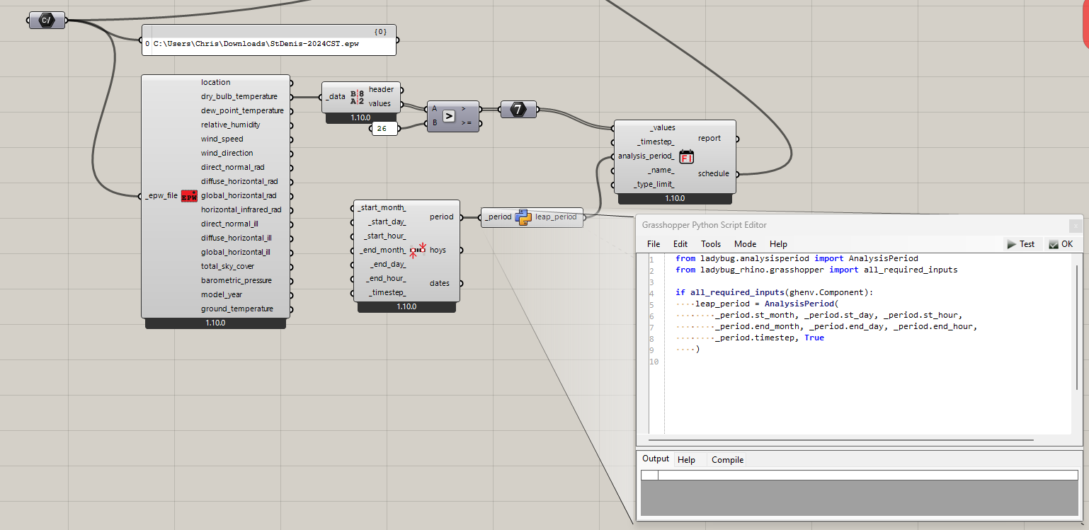

I implemented the support for leap years on the SDK layer of Ladybug Tools and I did not expose it on the official components because it can make the management of GH scripts harder for new users if they have to consider whether each analysis period instance is a leap year or not. My thought was, if a person is advanced enough to be running simulations of leap years or working with leap year EPWs, they can probably also just make a Grasshopper component with a little Python in it to convert the analysis period to a leap year. This way, the advanced people can still get what they need with a little Python in a GH component while all other users are unaffected by the complication of managing leap year data.
Here is a Grasshopper script with a custom component for conversion to leap years:
leap_year_sim.gh (61.3 KB)
You should see that it can run the simulation of the EPW:

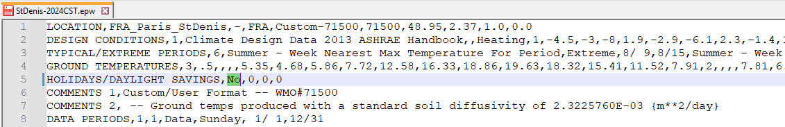

… but I had to edit your EPW since it was invalid. It had the Leap Year flag in the file set to No, which does not align with the rest of the data in the file:
Here is your fixed EPW file, which should work well with all of the Ladybug Tools components:
StDenis-2024CST.epw (1.7 MB)
Also, FYI, this type of invalid EPW has come up enough times that I just implement a patch that tries to accommodate it. Certain edge-case functionality with invalid EPWs like this might not work correctly but everything you do with the EPW in the official Ladybug Tools Grasshopper components should work as long as you convert your Analysis Periods to leap years using the custom component in the script I posted above.
