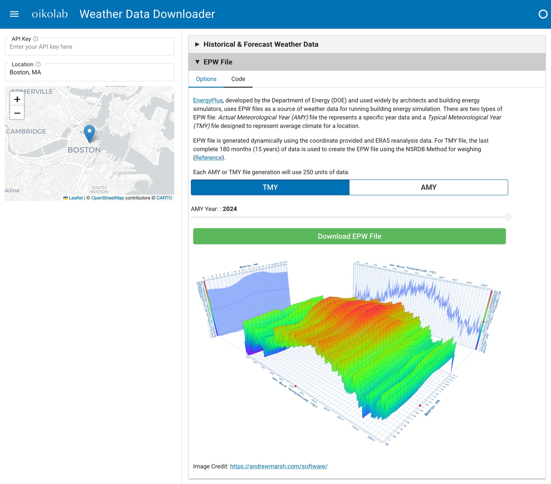

Hi @GerardoD - thanks for the kind feedback. You can sign up for an account at https://oikolab.com and you will be assigned an API key which you can see in your profile.
If you’re not a programmer and you’d like to download an EPW file, you can download it by pasting your API in the top-left text box you see below:

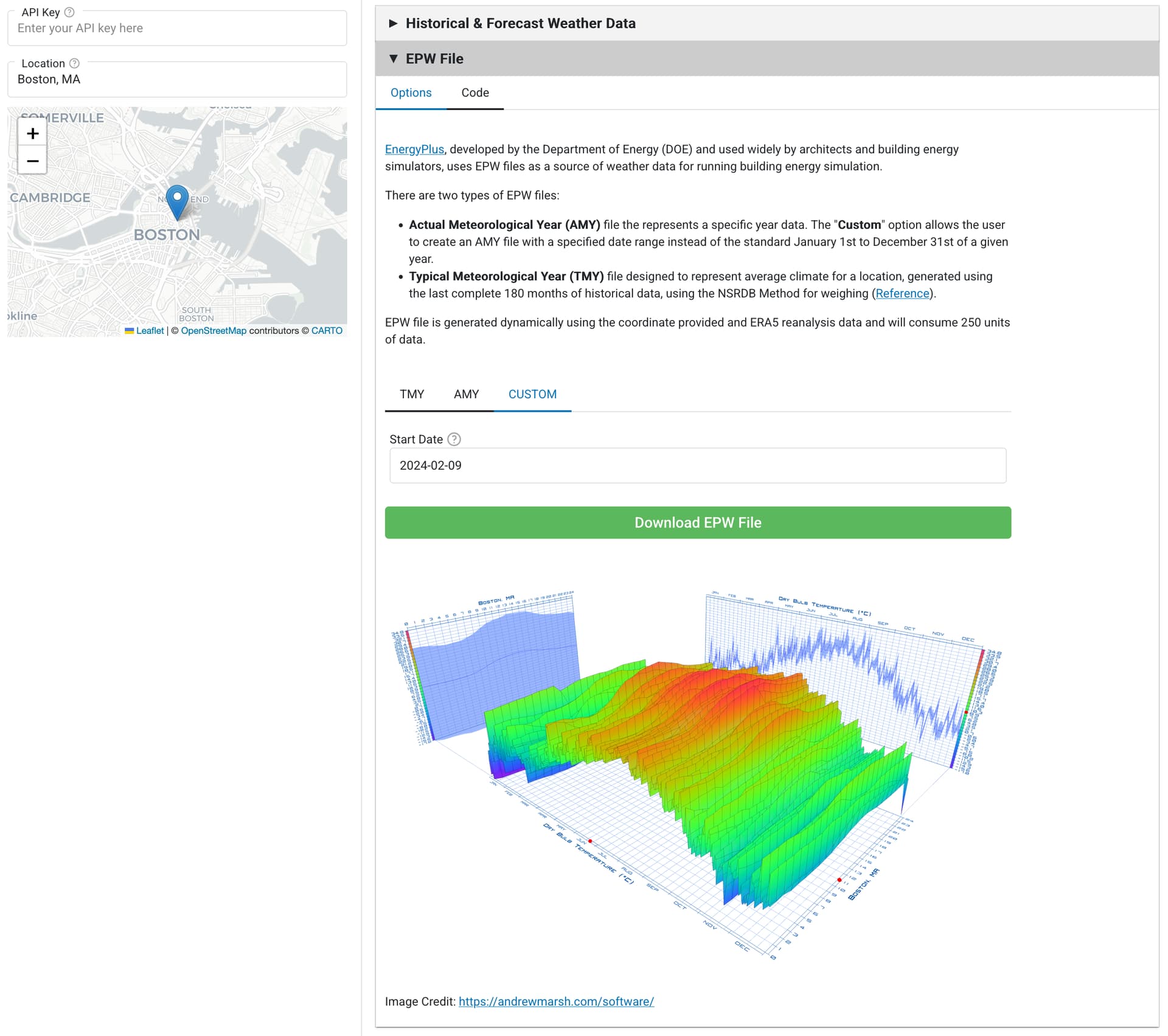

FYI, the Downloader app and the EPW API endpoint have both been updated to allow users to create EPW files for custom date range.
