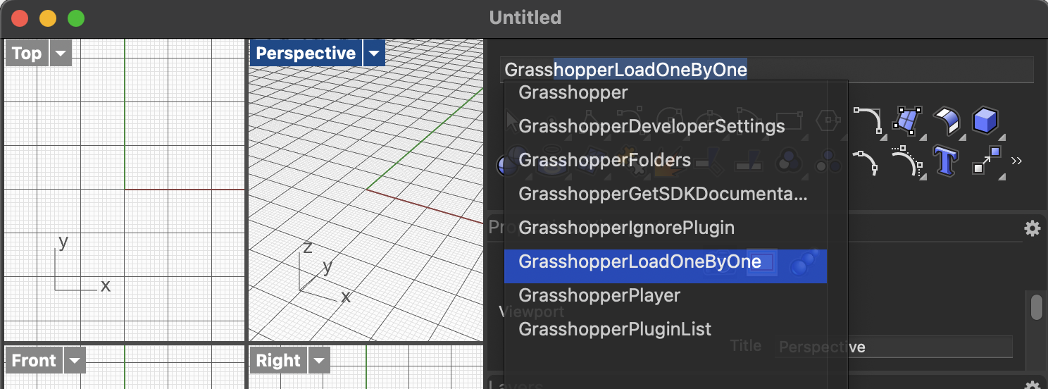

One thing you might try to see if it is a conflict with any other plugins you have installed is to load grasshopper in ‘One-by-One’ mode, and to say ‘no’ to every other plugin except Ladybug.Grasshopper.gha and GhPython.gha.
You can use the command GrasshopperLoadOneByOne from Rhino to start Grasshopper this way:
Then see if you can add an LBT component to the canvas without crashing?

I also tried the command GrasshopperLoadOnebyOne loading just the two plug-ins you told me to leave, but still I cannot drag a LBT without Rhino and Grasshopper to crash.
