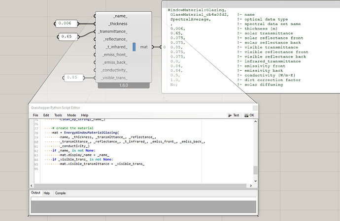

I am trying to model the total solar radiation transmitted from a window,
whose glazing has a solar control coating. When a glass has a coating (e.g. solar control or low-e), the solar reflectance of the glass frontside and backside should differ. My problem is that the HB Glass Material component has only one input called “reflectance” to set the frontside reflectance (the input calls it “frontside” if you hover over). I set this value, and then when I look at the material that is output from the component, I can see that the same value has been assigned to both front and back sides of the glass. Can someone please advise, perhaps @chris knows this, how can i set both the frontside and backside reflectance of the glass? Here is a screenshot that shows the issue:
Any advice would be highly appreciated.
@behroozkhalilinasr1 ,
The solar_reflectance_back is exposed on the SDK layer of honeybee_energy. You can see it under the EnergyWindowMaterialGlazing class.
So you can set the back reflectance to be something different than the front using a line of Python inside a GHPython component like so:
mat.solar_reflectance_back = _ref_back
Here’s a sample:
custom_glass_material.gh (13.2 KB)

Not sure if I understand, @Matcos . The visible transmittance isn’t exposed on the component because it doesn’t really affect the E+ simulation for most cases. The only case where it can have an impact is for the daylight sensors assigned with the HB Apply Daylight Control component. But these aren’t nearly as accurate as a Radiance daylight simulation and they’re really just giving you a general sense of how much lighting energy might be saved if there were daylight controls.
Still, if this is the use case that you are worried about, then just tweak the source code inside the HB Glass Material component.
change_visible_trans.gh (8.2 KB)
