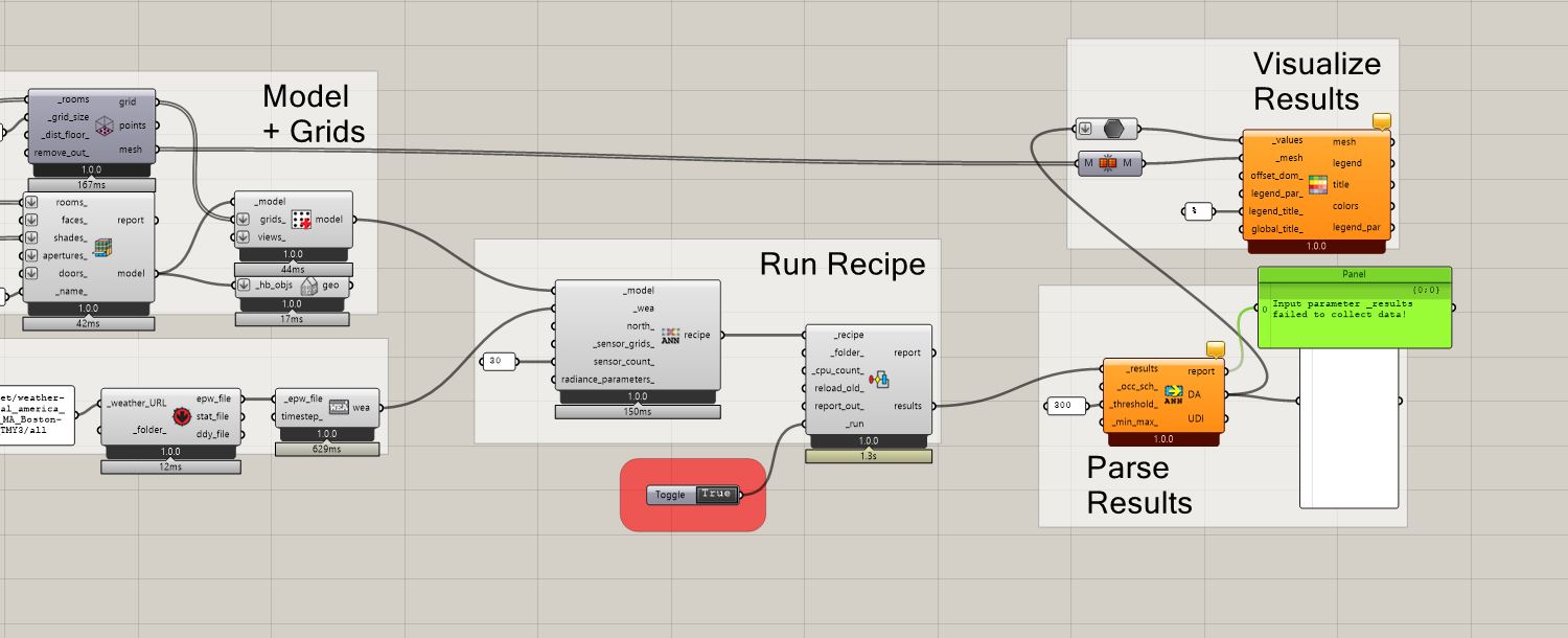

I am trying to run an example file from one of Mostapha presentation of LBT 1.0.0.
When I click in run recipe a black window appears for 1 second and the HB Annual Daylight Metric shows “1. Input parameter _results failed to collect data!”.
I don´t know what I am doing wrong.

Hi @oscar.buchely, dis you check the Radiance installation on your machine - does it comply with what’s needed. We had a number of similar discussions on the forum.
Thanks Mostapha. I checked the compatibility Matrix and it seem that my requirements are OK. I have Radiance 5.3 installed. I think I have the same issue as this.
https://discourse.ladybug.tools/t/sample-files-wont-work-everything-up-to-date/12923

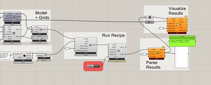

Can you use report_out option and copy the error message here?
Do you mean this report_out?
“Input parameter _result failed to collect data!”

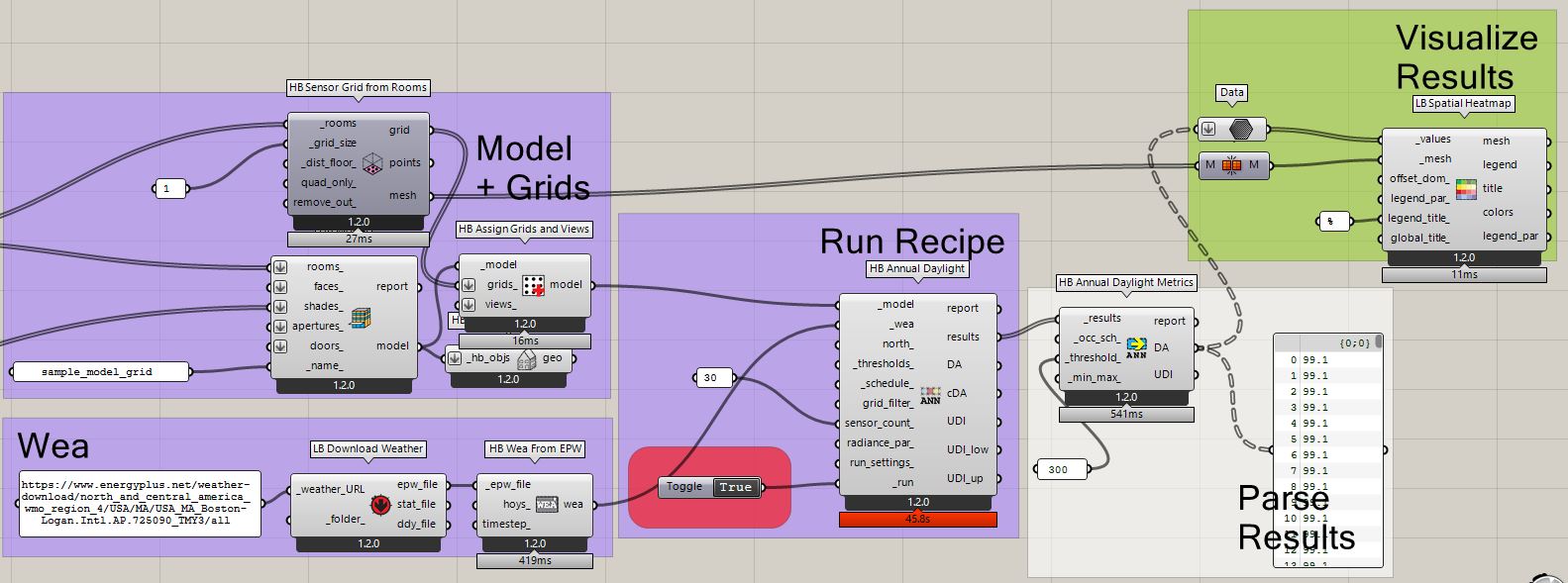

I updated to LB 1.2.0 then add LB Sync Grasshopper File, updated manually all LB components to 1.2.0 and ran the simulation. It does run without a problem.
I did not have to use HB Run Recipe component in 1.2.0

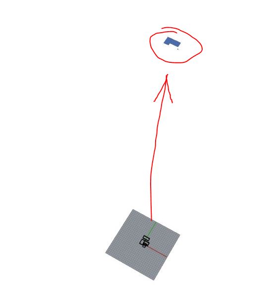

The Visualized Results (LB Spatial Heatmap) seem to be some kilometres up the geometry, but I suppose I have missed an offset value somewhere.
4-HB-R_annual_daylight V1.2.0.gh (62.6 KB)

What are your Rhino model units? If they are millimeters, then the issue is that your rooms are only a few millimeters long and not that the result mesh is a kilometer above.
