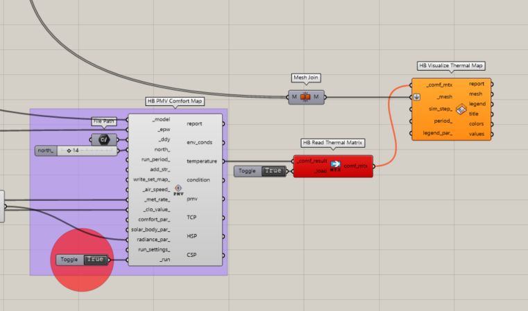

This is the error message: “1. Solution exception:Failed to find C:\Users\fabbe\simulation\Nuova_stazione_di_Kapteinsklip\pmv_comfort_map\results/condition_intensity\datacollections\Room_10.csv”

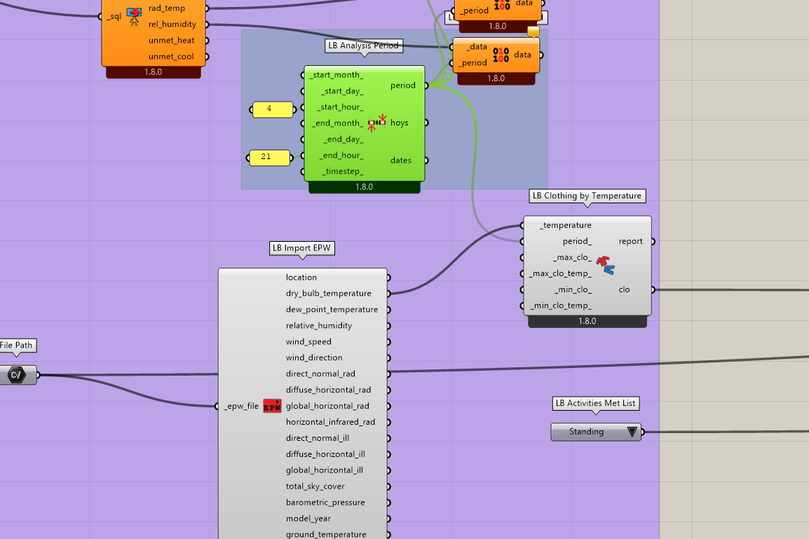

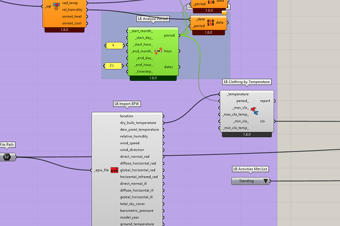

We should probably have a better message for this somewhere but the issue was that you connected an analysis period for the LB Clothing by Temperature component and this did not match the run_period_ specified for the HB PMV Comfort Map component.
Once I disconnected the Analysis Period, it all ran fine.

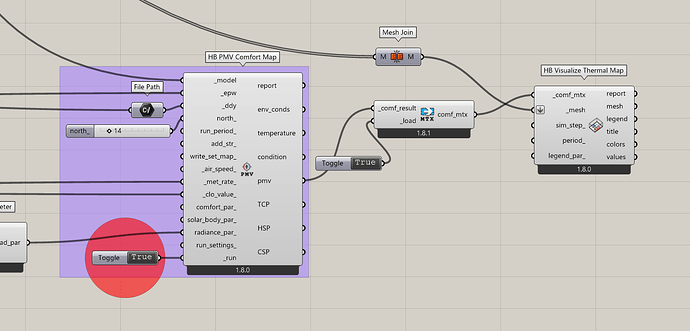

Here is the fixed file:
250605 Trimmed Comfort_CWM.gh (202.2 KB)
