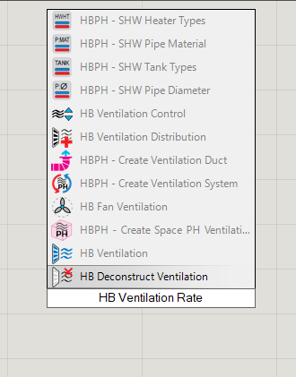

I just made a bunch of improvements to the ventilation object in honeybee-energy so there may be a bug here. There is no HB Ventilation Rate component:
… so I don’t know what component you are actually referring to here.
If you mean the HB Ventilation component, make sure that you have run the LB Versioner and are using the latest version of the component, which now looks like this:

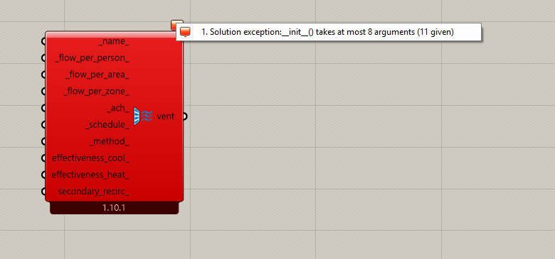

Chris,
I’ve updated everything, but I’m still getting a similar error:
kr,
It’s clear that you have older core libraries running, @Thomas, which are not compatible with the version of the component that you have there.
So whatever method you are using to update is not updating your core libraries correctly.
Have you tried uninstalling completely and reinstalling via the pollination single-click installer? If that is not fixing it for you, check your rhino IronPython paths and, after you uninstall, make sure that there are no other ladybug_tools paths that are overriding the one that you are supposed to be using with the single-click installer:

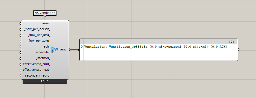

C:\Program Files\ladybug_tools\python\Lib\site-packages
Thanks for this @chris On using the latest version of the component, it is now functioning properly
