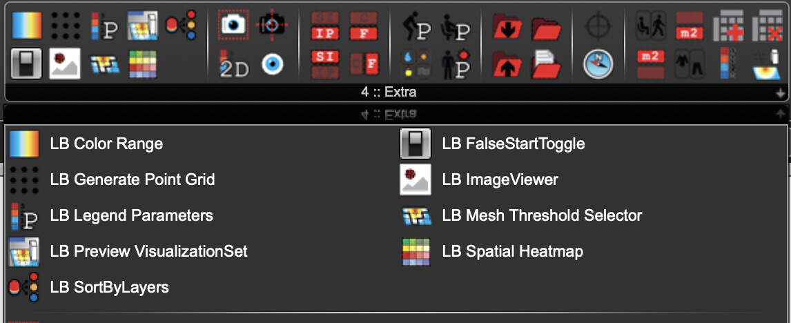

I’ve just updated my installation with the LB Versioner component, and I failed to find the LB Samples component:
So I uninstalled everything and did the step by step install again manually, same result – no samples component for me.

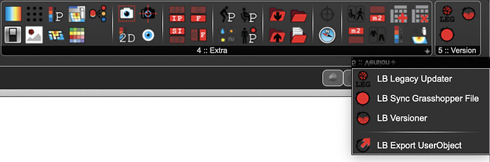

Your screen capture shows it under the 4 :: Extra tab, the documentation is listing it for 5 :: Version. I can’t find it anywhere:

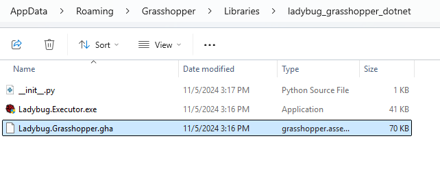

The new LB Samples component lives in the Ladybug.Grasshopper.gha file inside the ladybug_grasshopper_dotnet folder where your components are installed:
.gha files cannot be deleted or overwritten while Rhino is open. So there is no way to delete it when running the LB Versioner. So, if you want the new component, you have to delete that .gha file the entire ladybug_grasshopper_dotnet folder manually while Rhino is closed. Then, open up Rhino and run the Versioner. The next time that you open Grasshopper, you will have the updated .gha and the LB Samples component.

However, on the Mac side I still struggle to get it going. I have manually deleted the Ladybug.Grasshopper.gha and re-run the Versioner: there is no updated .gha in the folder - it remains missing.
