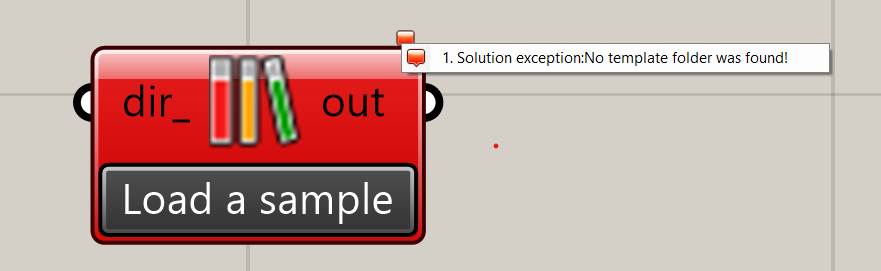

I was browsing all the updates with the new LBT in the GH and I had the same issue as this post: Can not find LB samples component @chris
Once I resolved the issue then a new error was popped up (No templet folder was found!) see screenshot below.
Is there any way to fix this issue?
Thanks in advance,
Bernard
Hey @zengwoo1028 ,
How did you install Ladybug Tools? Did you use the pollination installer or the food4rhino installer?
I used food4rhino installer when I installed the LBT.
Ok. Then do you see a folder of sample .gh files at the following location?
C:\Users\[USERNAME]\ladybug_tools\resources\samples
That is the samples folder that the component is looking for. If it is not there, then the installer did not run correctly and it might be worth uninstalling and reinstalling again. If, however, the folder is there, maybe there is just a permissions issue with the component trying to access the folder in that location.
