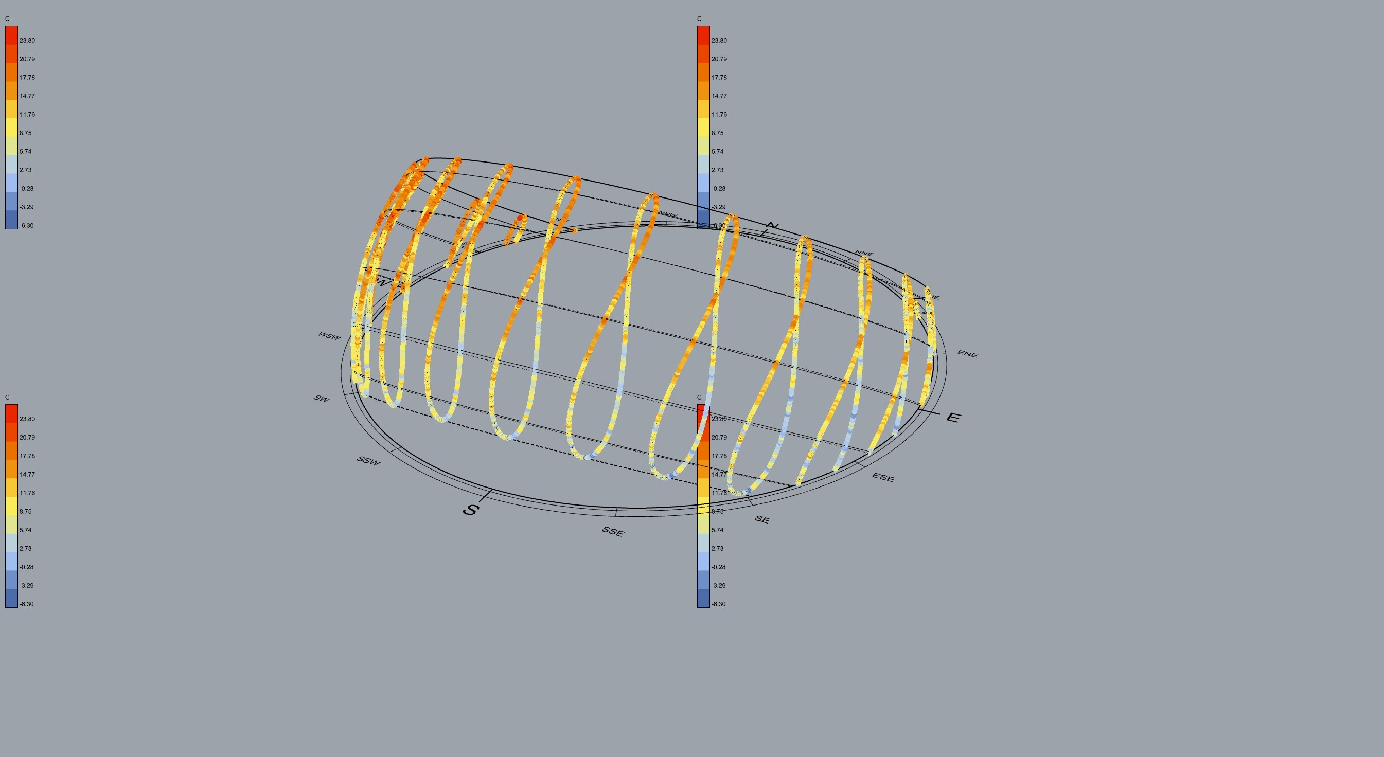

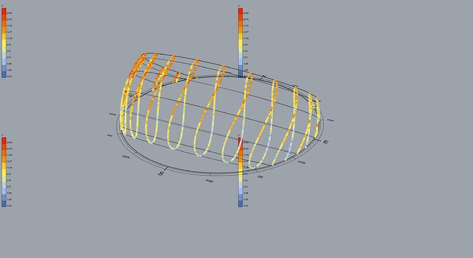

I’d like to report this graphical bug when using the [ViewCaptureToFile] command in Rhino with the 2D legend enabled. When capturing screenshots, the built-in View capture in rhino glitches both while previewing and upon export. Using Ladybug’s Built-in [LB Capture View] component doesn’t do this, which is my workaround for the moment. Using Latest version of Ladybug (1.6).
Please see attached images:

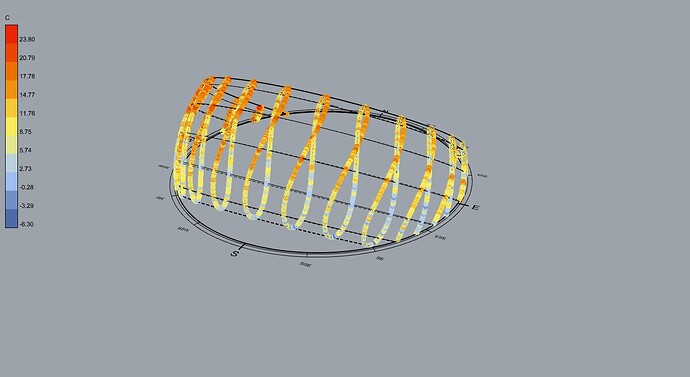

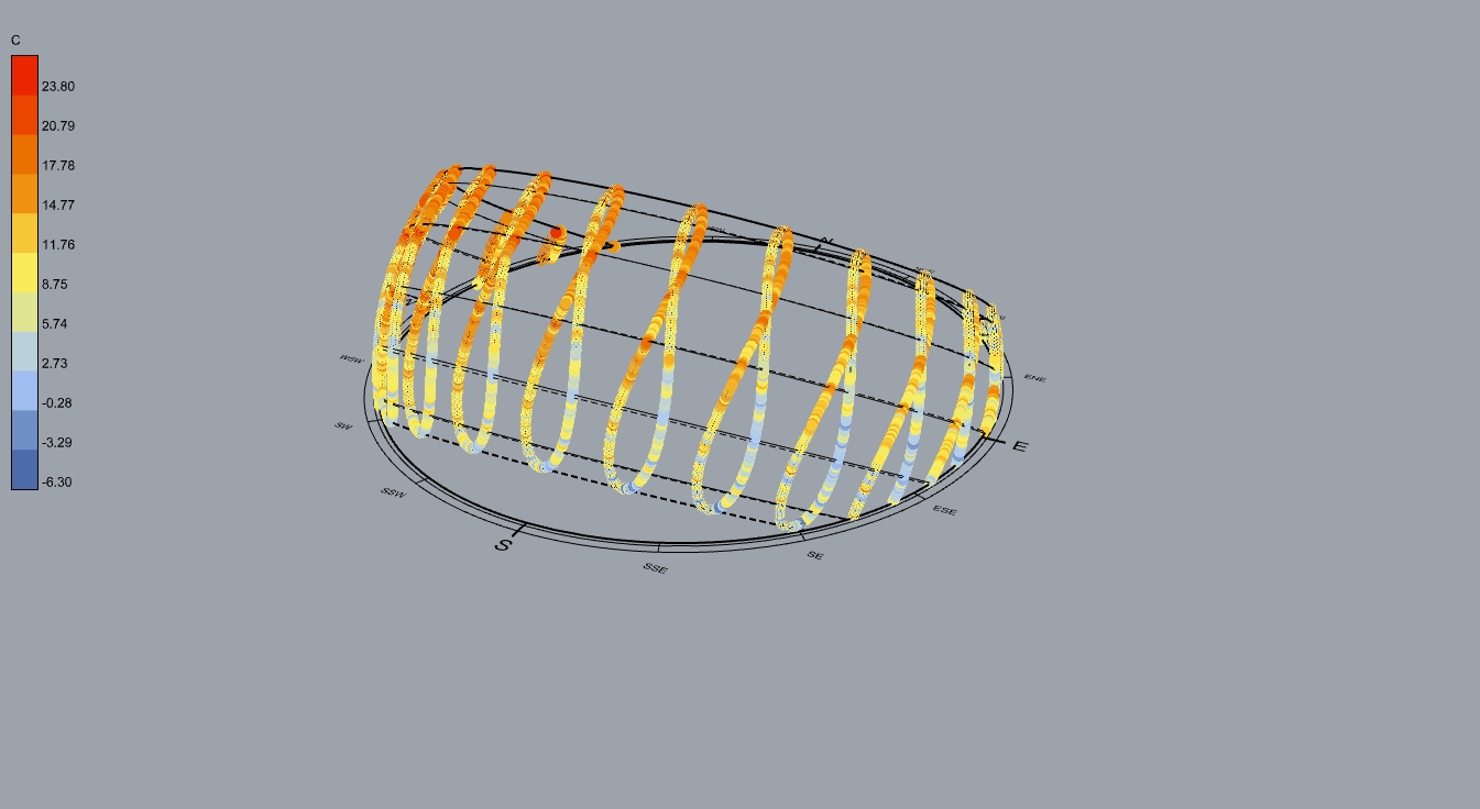

I can confirm I get the same issue when scale is set to 2. When scale is set to 1 I get an image that reflects the viewport:
Scale 2
Scale 1

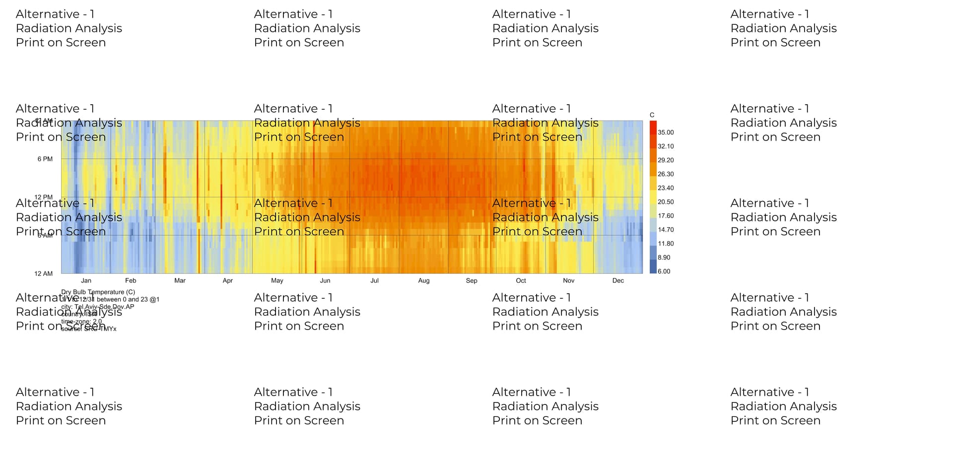

We have the same behaviour on our side: The hourly plot (for instance) is fine, but the 2D Text/Legend

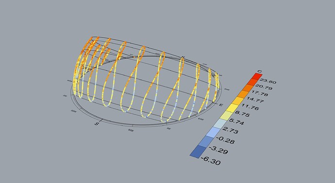

The only thing I can offer is a workaround with the 3D legend, which is a little bit more work to set up but it will look excellent in whatever screen capture that you make. All that you have to do is NOT use the 2D legend parameters and instead plug in a base_plane for the LB Legend Parameters. You can use the LB Orient to Camera component to get a plane that is oriented to the screen like so:
visualization_set_3D_screen_orient.gh (37.2 KB)
Your legend won’t stay in one place as you navigate around (you’ll have to re-compute the “Orient to Camera” component for it to get the latest screen orientation). However, it will not be repeated when you use and of the “Screen Capture” workflows (either with the Ladybug component or with the native Rhino command).
