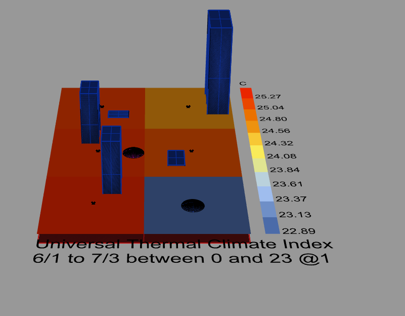

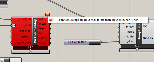

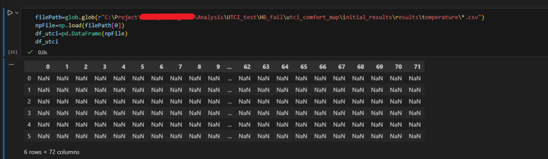

I am trying to use the UTCIMap component (v1.9.0) to resolve the UTCI spatially for a sample project site. However, I find that whenever my analysis period is less than a month, the simulation runs but gives NaN values. However, if it is over a month, the results are normal. I have uploaded a screenshot showing the successful results’ visualisation, as well as two screenshots of the failed results’ error and NaN values.

In short, the recipe saves the various NumPy files using the lowest possible data type without compromising accuracy, in order to reduce disk space usage. In your case, the issue occurred during the UTCI matrix calculation. The air temperature file used in that step was saved as float16, which led to overflow issues later in the NumPy calculations.
I suspect the annual/monthly analysis worked because the same file was saved as float32 at that time (it now contains different data).
I’ve updated the code so that all files are converted to float32 during the calculation process to prevent this issue.
