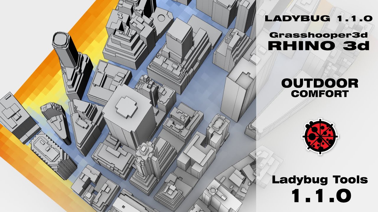

I have followed this tutorial
It is really helpful, but doesnt deal with multiple levels, but a ground in an urban setting. I am know wondering if I can only evaluate level by level using the slab above as context instead.
