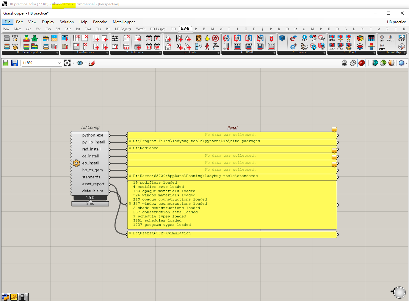

Looking at this more, it’s kinda like Rhino 7 is completely unable to see certain files on your machine. Can you open this Grasshopper file and post a screenshot of what you see? It should look like this:
If it doesn’t look exactly like that, can you verify that the file at C:\Program Files\ladybug_tools\python\python.exe actually exists on your machine?
Ok, I think we’re getting close to knowing what’s going on. It looks like the setting of your ladybug_tools_folder might not be correct. I can’t figure out why it would be different between Rhino 6 and 7 but all of the symptoms from your screenshot suggest that the ladybug_tools_folder is not correct in Rhino 7.

However even I ran the cmd line and reopen and check, the GhPython Script shown the same as if it didn’t change, or got alter when the software reopen…
I think I probably know what has happened now. The pollination installer is supposed to delete that older installation of Ladybug Tools at:
D:\Users\63729\ladybug_tools
but I am guessing that the installer could not find it because it’s on the D:\ drive instead of the C:\ drive. CC: @MingboPeng
In any event, I have one last suggestion, which is to just manually delete that folder at:
Hopefully, after that and a restart of Rhino, everything should work. Or, if it doesn’t, we will see exactly what has caused this mismatch between your Rhino 6 and Rhino 7.
After deleting several folders in \AppData\Roaming\McNeel\Rhinoceros\7.0\scripts and run installation_test.py, the output seems normal now.

It seems that you must have installed some very old beta version of the LBT plugin before version 1.0 was released since we have not put the libraries into the Rhinoceros\7.0\scripts folder for at least 4 years now. I remember we initially debated putting the libraries there, though, before the LBT 1.0 plugin was complete. So maybe you got a hold of some extremely old installer that wasn’t meant to be released publicly or that we forgot to take donw.
