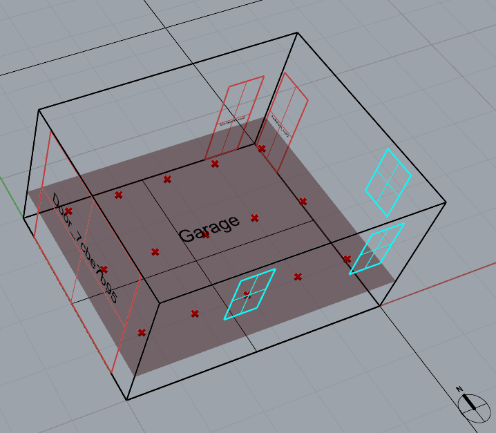

Thank you for your reply, and sorry for not explaining myself properly, it was my first participation in the forum. Hope it’s a bit clearer now: I made the model simpler, it’s in the Southern Hemisphere, I put only one room, with the doors in red and windows in light blue:

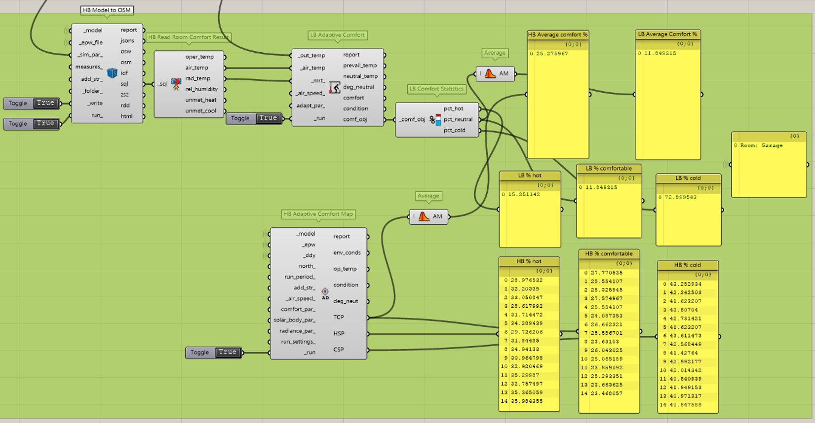

Trying the 2 workflows to simulate the comfort levels (1. HBModelToOSM - LB Adaptive Comfort / 2. HB Adaptive Comfort Map), I got these different results:

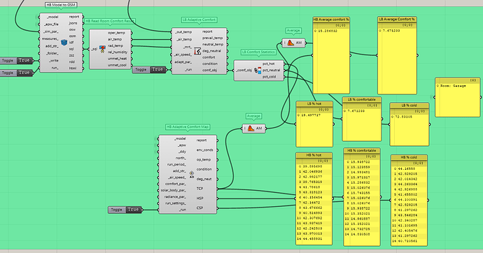

From what I can see, the percentages of time feeling comfort, hot or cold between the 2 workflows is significantly different: Comfort time 11% vs 25%, Hot time 15% vs >30%, Cold time 72% vs <45%.

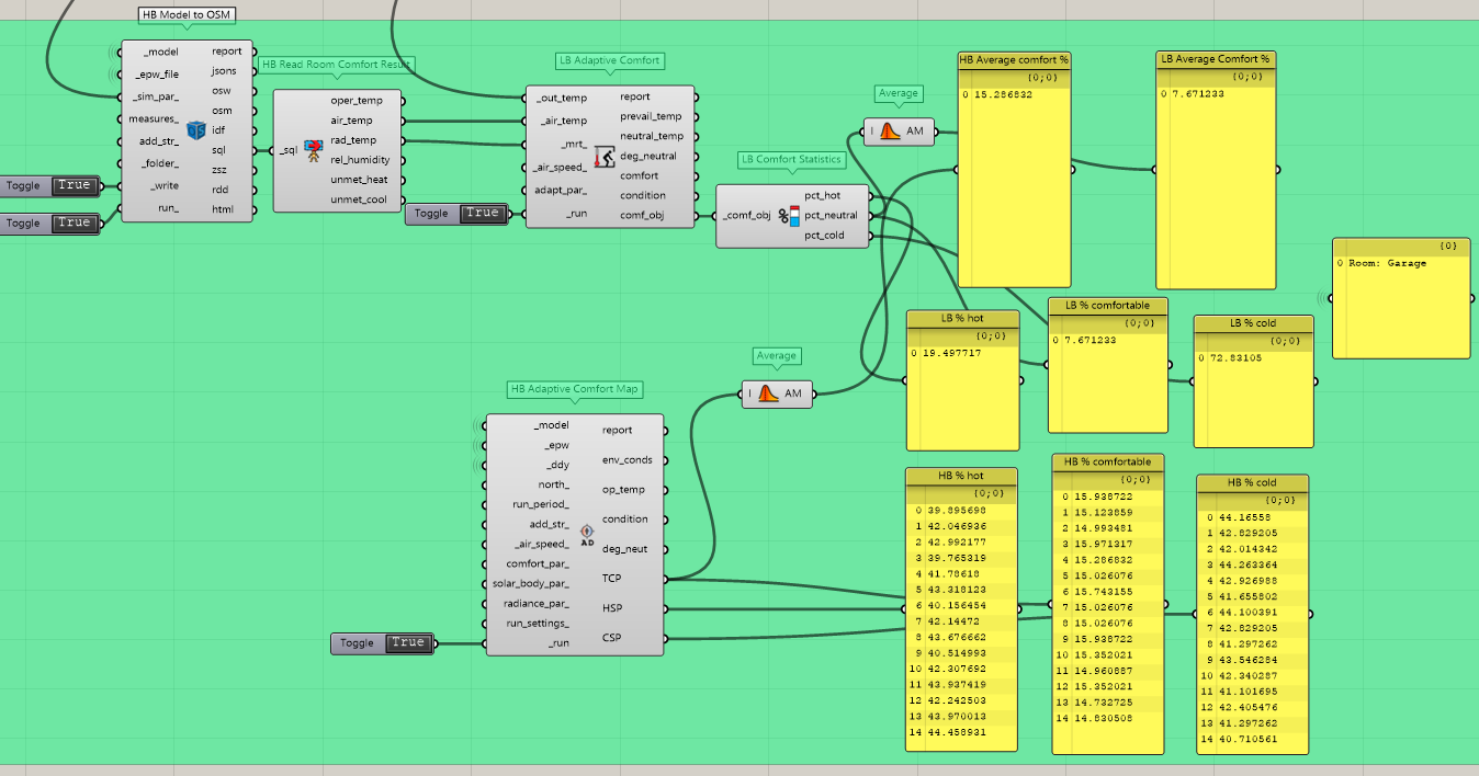

I don’t know if there’re more considerations apart from the sun falling on occupants taken into account in the 2nd workflow. I tried also the same model but with no windows, and it’s still very different between both:
I’m attaching the Grasshopper file just in case. Maybe I made some mistakes, I’m still in pretty early stages learning about Ladybug Tools.
My questions are: What would be the reasons for these significant differences? What workflow would you suggest to use, that is closer to reality?
