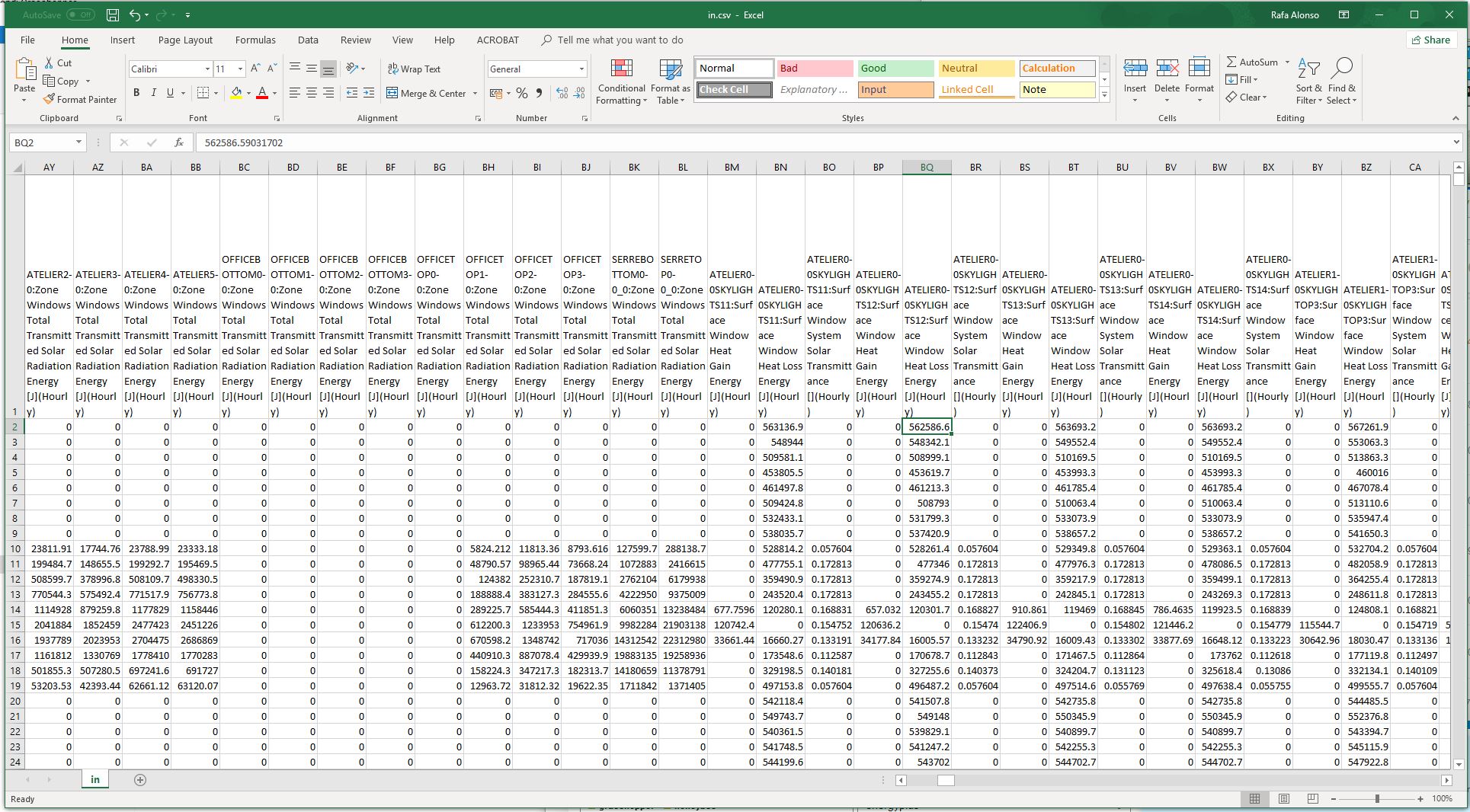

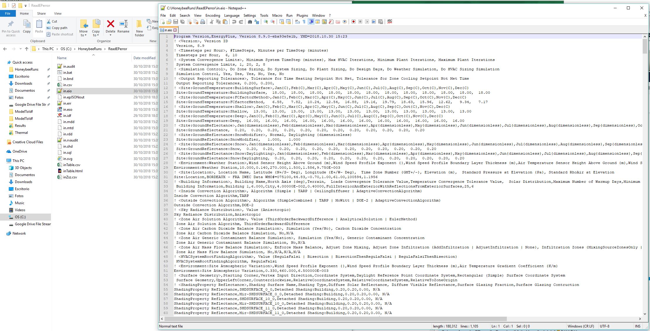

I’ve been randomly running into this error in the last weeks, and I completely fail to understand where is it coming from. I wrote the .osm and .idf files with HB export to Openstudio component, on a separate definition, requesting the Surface outputs. I then modified a few things in the .idf with EnergyPlus before running the .idf with EnergyPlus 8.9 itself.

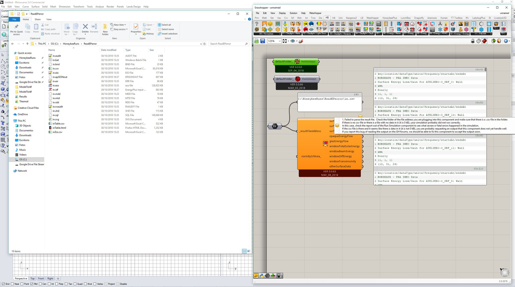

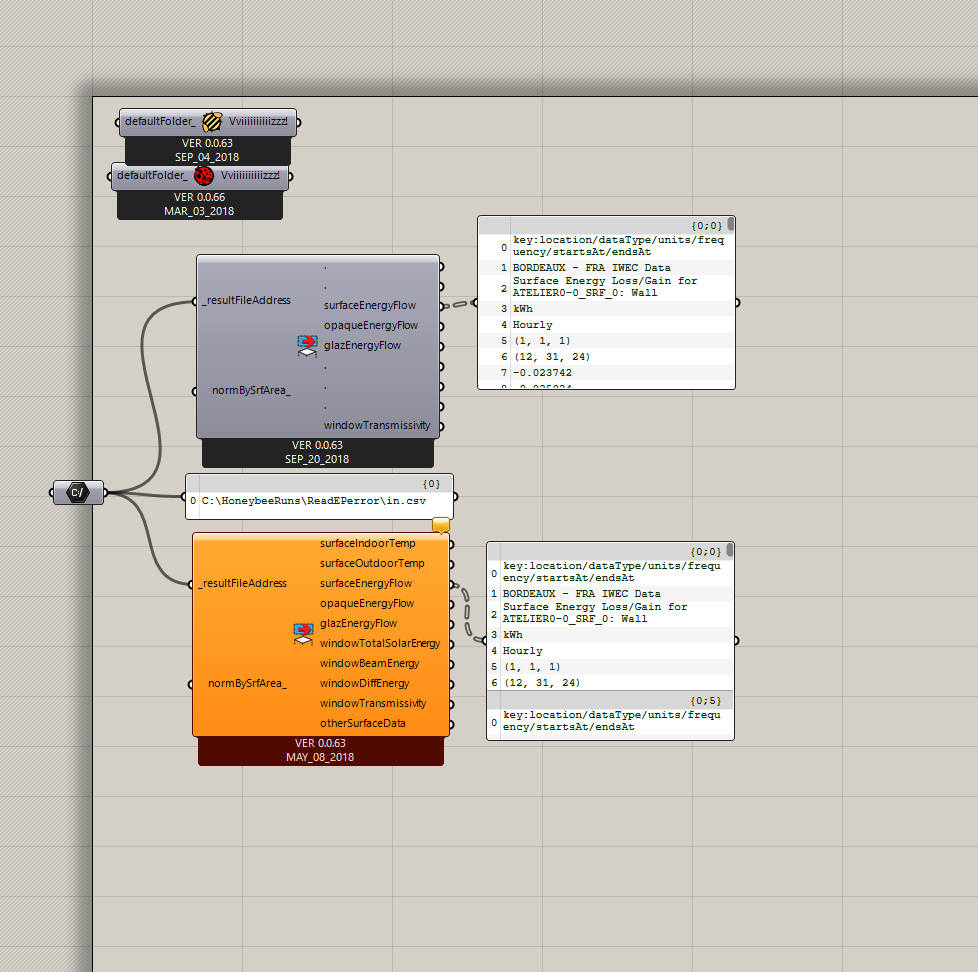

I tried parsing the results inside the .gh definition used to export the thermal model, in case something was being stored in the RAM and used later by READ EP Surface result, but still the same error. Surprisingly enough, the right headers are generated in any case.
