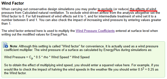

I am working on an energy model and i would like to isolate some results without the wind effect and compared with how much the wind impact is. This model has a series of operable rooflights that will open in the night for flushing the heat, so i do want to account for other effects such as buoyancy.
I have done this before in Design Builder by reducing to 0 the wind factor of the operable openings, so i guess than in theory this could also be done in Honeybee (they both use E+), but i just cant figure out how. As it is mentioned in the DB help it is a Cp multiplier basically.

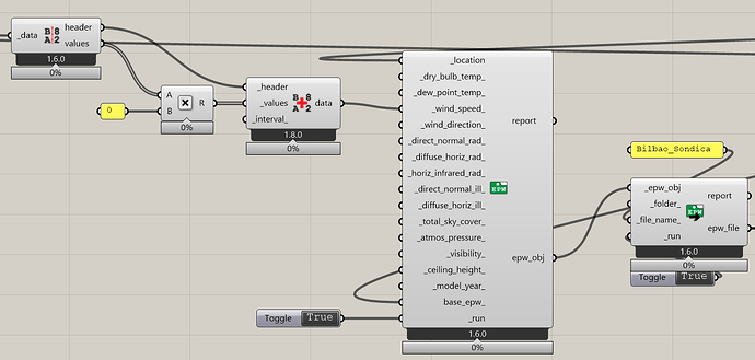

Otherwise, an alternative solution is to read the .epw in, and overwrite wind with 0, and then construct it again. Perhaps a dumb solution, but workable.
yours,
LittleBuddha.
Thanks @LittleBuddha. Yes that was the workaround i thought about, however the convection losses of the envelope are not considered either, so it is not exactly accurate, but for now i will go with this.
