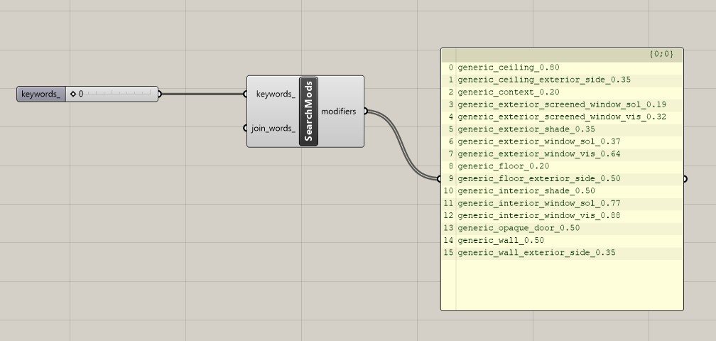

I have the same question. I use the component below, because I do not want to assign rad materials in every HB surface. However, how can I separate the external from the internal walls? If I connect the interior walls’ rad materials to the wallRADMaterial then I ignore the rad materials for the external facade.
Can anyone help ? Thanks!
Hello. I was wondering what is the “default” modifier material for the interior walls when we use a shoebox (without changing any rad_modifier values)? What reflectance and color values are the default for the walls? Is it the same for the floors as well?
Thanks
