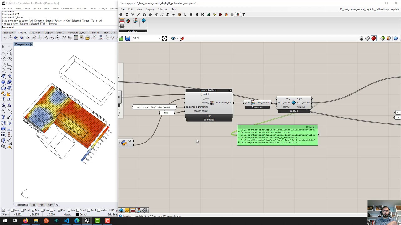

Some will be available soon like Irobug integration. @MingboPeng, has already done some work on this. @AntonelloDiNunzio can comment on the EnviMet integration. he renewables will take some time to be translated - the same can be said about THERM unless we get a contract or a project to change the schedule.
It’s already out and functional! Technically I should not share this video publicly and wait for the updated version that we will record soon but life is short! This is how it works! :slight_smile:
