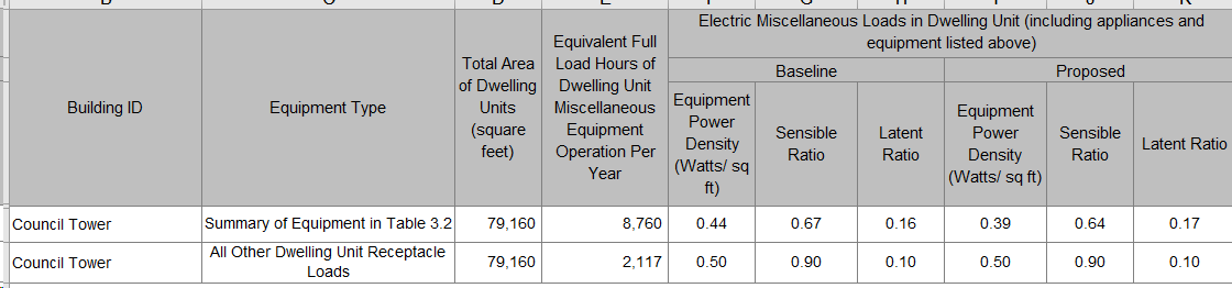

I wonder how can I define two electrical equipment loads. for example, a receptacle and another one based on the multifamily calculator in the Honeybee, I can do it easily in Openstudio, have two equipment load for a zone but I don’t know how can I do it in Honeybee. Would be thankful if anyone help me. I think something like the equipment group in Ironbug I need here.
I want to have two electric equipment for a zone as I can do it in OpenStudio.

I want to model these two equipment that I have in ESMFHR calculator.
