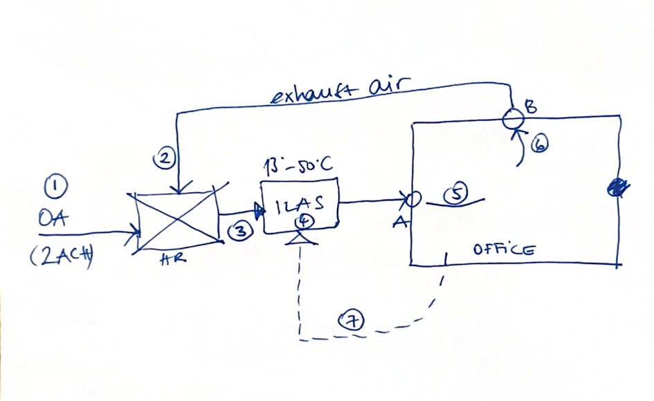

Hi everyone,
i have been using ILAS (ideal loads air system) for a while now and i am trying to understand how it works. i have done a little sketch from what i believe this is how it works. I would love to hear your opinions if i got this right.
Hello @Chrew, Here is a link to the energyplus documentation for ideal loads air system
hopefully you find it helpful.
Hi
This thread is possibly helpful too
It is a confusing component, but once you get confidence in what the outputs actually represent, it should be useful in your workflows.
