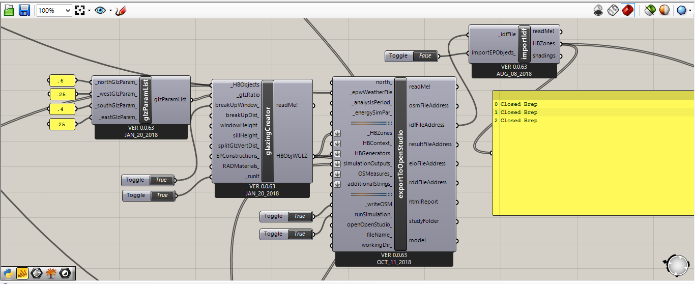

****When I am applying glazing on my honeybee zones by using Honeybee_GlazingBasedOnRatio component, it’s giving me warnings. I don’t know again that this is an update issue or something else :thinking:. I have tried using both Honeybee_RunEnergySimulation and Honeybee_ExportToOpenStudio components but in both the cases glazing surfaces are missing in the final IDF file.
Case 1: By using Honeybee_ExportToOpenStudio component
Glazing surfaces are missing in the final IDF file and Honeybee_ExportToOpenStudio component not even giving any warnings about this.
Case 2: By using Honeybee_RunEnergySimulation component
Glazing surfaces are missing in the final IDF file and Honeybee_ExportToOpenStudio component is giving warning i.e. “Failed to build fen srf
I am attaching my files and screenshots for your reference.

I have the same problem that you had with the missing glazed surfaces in the idf-file. Did you find any solution fro that problem?

I rebuild my project from the scratch…As per my knowledge…I was facing that problem because of compatibility issues in open studio, energy plus and honeybee.
Okej, then I try to update EP, OS and HB. Are you running the latest updates?
Yea…I am using the latest versions…but for full compatibility you can use open studio 2.5 instead of 2.7
I’m facing the same issue. I don’t understand how creating from scratch would help, since I will be doing everything pretty much the same. Also, I couldn’t find any links to download legacy versions of Open Studio. :confused:
i was having this problem, so i downgrade the open studio 2,7 to 2,5 and the windows come back :smiley:
