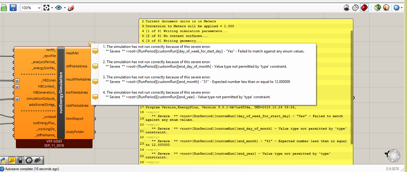

Hi…I connected the simulation outputs from the Honeybee_Generate Ep Output component to the simulationOutputs_ on the Honeybee_run energy simulation component. After that, I simulated and got these errors.

If you are using the latest version of OpenStudio then you need to also use the latest version of Honeybee. There has been a change in EnergyPlus RunPeriod object and that’s why it gives you an error.
@chris, I thought the fix in this case is backwards compatible but it seems there are cases like this that can fail.

Use the exportToOpenStudio component instead of the runEnergySimulation. It runs fine.
Seems to be that the later is writing wrong different fields in the IDF. Right now i can’t check and show that but @chris should be aware of this (probably) bug.
In my case EnergyPlus 8.5 and OpenStudio 2.1 it runs without any severe errors
OK. So probably the issue is related to EnergyPlus9 and/or OS 2.7, which i also have installed. The exportToOpenStudio will do the job fine.
