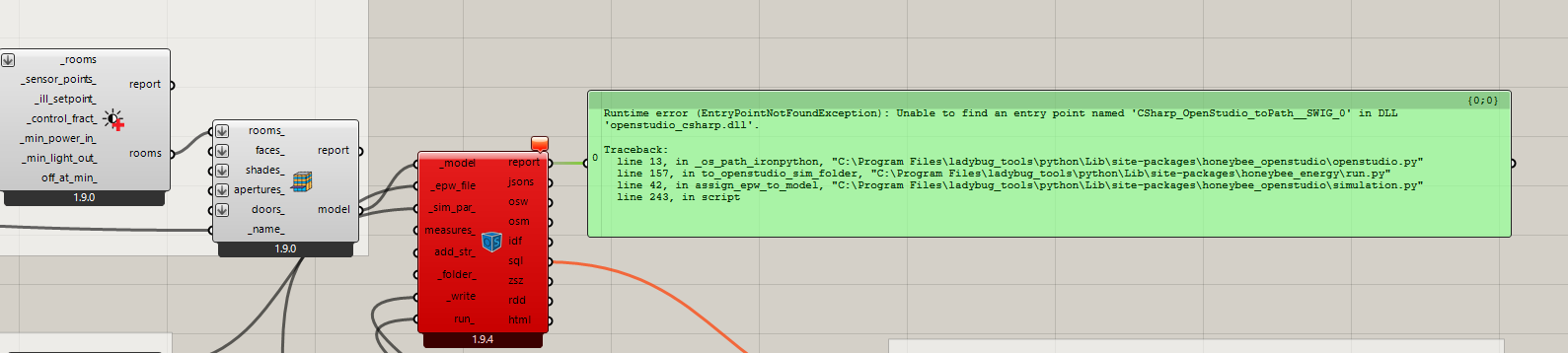

Currently having the following error:
There’s some more lines of information to the error, they are the following:
"Runtime error (EntryPointNotFoundException): Unable to find an entry point named ‘CSharp_OpenStudio_toPath__SWIG_0’ in DLL ‘openstudio_csharp.dll’.
Traceback:
line 13, in _os_path_ironpython, “C:\Program Files\ladybug_tools\python\Lib\site-packages\honeybee_openstudio\openstudio.py”
line 157, in to_openstudio_sim_folder, “C:\Program Files\ladybug_tools\python\Lib\site-packages\honeybee_energy\run.py”
line 42, in assign_epw_to_model, “C:\Program Files\ladybug_tools\python\Lib\site-packages\honeybee_openstudio\simulation.py”
line 243, in script"
It may be unrelated but it seemed to start happening after installing Pollination for Rhino. Previously I just had Pollination for GH and it worked fine. I checked unistalling the Rhino version of Pollination and re-installing just the GH version but I got the same error message.
Currently using:
  • Rhino 8.21
  • GH 1.0
  • Pollination 1.65.10

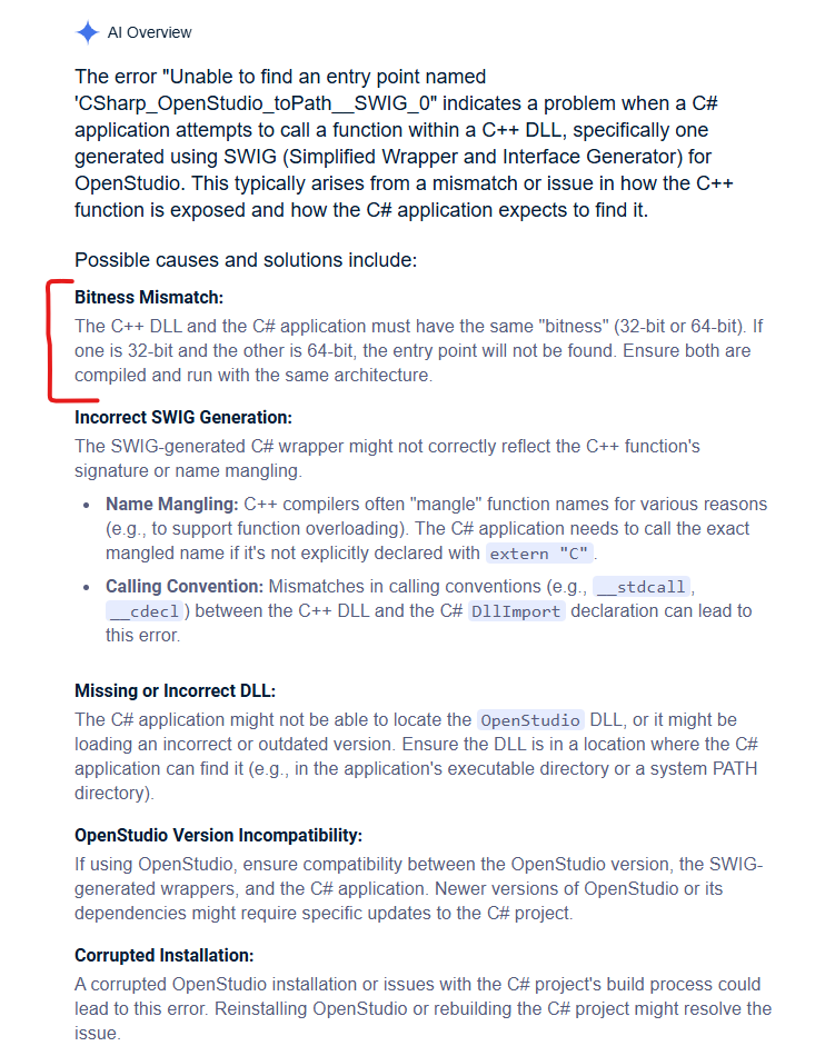

I also have one more very important question that I realized thanks to google-searching the error:
Is your Windows operating system 64 bit or 32 bit?
If it is 32-bit, then we have identified the problem and I can probably add an extra check to be sure that the bitness matches between your Operating System and the OpenStudio C# bindings before we try to load them.
