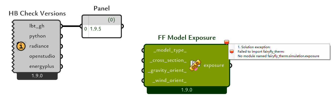

hi,@chris

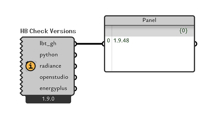

This is the issue that I intended to bring up to you last time.
I will almost always use this process to perform an online update at regular intervals, in order to incorporate some new features into my current LBT.
After I complete the execution, I can see the relevant information indicating that the new version is ready.
But after I restarted my Rhino, when I checked the LBT version using the HB Check Versions component, it still showed the previous version that had been updated.
And I observed for a while, and I found that not every update failed. For instance, before and after fairyfay officially joined, I was able to use this update program to correctly incorporate the relevant components into Grasshopper.
At present, I can offer these references. If you need me to provide more information, please feel free to contact me at any time.
best.
Zhengrong

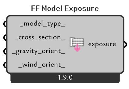

Do you find that you are also missing new components after you run the versioner? For example, on your machine above, do you have the new “FF Model Exposure” component that I just added this past Friday?
I’m just trying to figure out if t’s only an issue with the requirements.txt file or the whole plugin is not being updated by the Versioner.

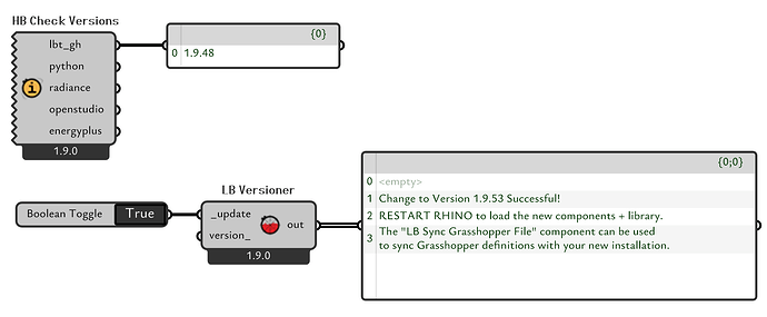

In the file C:\Program Files\ladybug_tools\grasshopper\requirements.txt
lbt-grasshopper==1.9.48
ladybug-grasshopper-dotnet==1.3.7
It is very likely that this file was not updated, which resulted in me not being able to pull down the version 1.9.53.
In the process provided in this post, I can see that the FF Model Exposure component is loaded into Ladybug Tools.
I tried to use the update program again, but it still pointed to version 1.9.48.
When I was observing the program’s operation, the modification dates of all the dependencies of Ladybug Tools were updated to the current time. So the update process should have been running normally, but it was unable to read the latest version from the current Github.
Furthermore, I attempted to manually execute the command "C:\Program Files\ladybug_tools\python\python.exe" -m ladybug_rhino change-installed-version to trigger the installation program locally, but it also failed. However, I still want to point out that when I specify the current latest version in version_, it is still possible to receive it.

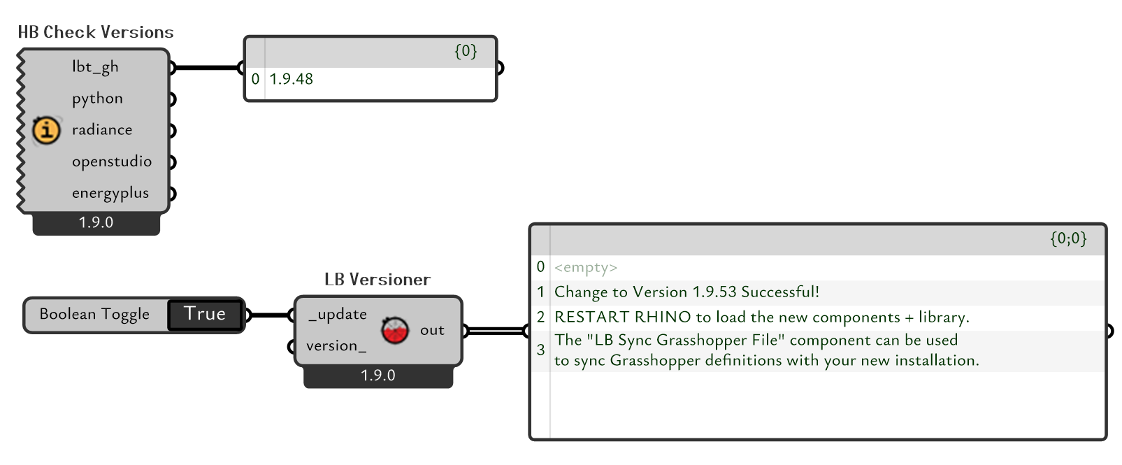

hi, @chris
In order not to interfere with the release of your new version, I am currently actively conducting local debugging.
I attempted to configure the environment within the virtual machine. The version used in this environment was lbt1.9.5, which is a relatively earlier version.
When I attempted to update using the LB Versioner component, it still informed me that I had successfully updated to version 1.9.53. However, after restarting, when using the HB Check Versions component to check the version, it remained at 1.9.5.
However, in this update, I found that the component library could be updated to version 1.9.53, including the complete Fairyfly components. However, the display of other dependencies was not able to load properly.

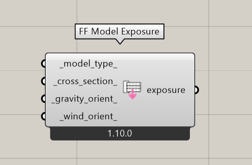

@ZhengrongTao and @grahamjlinn ,
SOLUTION
LBT 1.10 has been released and anyone using the LB Versioner from LBT 1.10 onward into the future will not experience this problem. So the recommendation for anyone who has this issue is just to install LBT 1.10 via the Food4Rhino installer or Pollination single-click installer. Then, you’ll never need to worry about the problem as long as…
