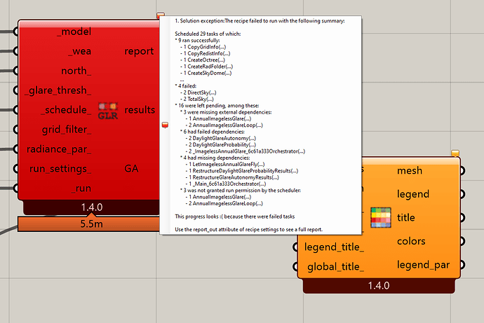

But I got one error message from below. Any idea?
I have the file named below
Hi @YD,
The error message suggests that the files are not in the right place. If you did follow the instructions in this post I am not sure why you get that error.
It seems like you have run a simulation? Your folder is polluted with the results, but I would suggest not to put anything in this folder besides __init__.py and gridbased.py.

Hi Mikkel,
thank you for your reply. It works now when only two files in the folder.
