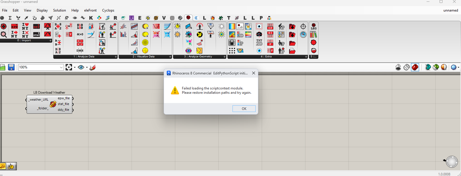

Hello all! When I used Revit and open Rhino using RIR and then open Ladybug tools this issue arises. Ladybug tools not loading in RIR. everthing works well when opened Rhino as stand alone. Already tried reinstalling. I am using revit 2027 and rhino 8 Sr35

Hi @TrevorFedyna I got a lead on this issue here 8.36.26279.07001 - broken python and plugins - #8 by kiteboardshaper - Rhino Developer - McNeel Forum
The latest hot fix for Rhino 8.26 has solved this issue. LBT loads now!
